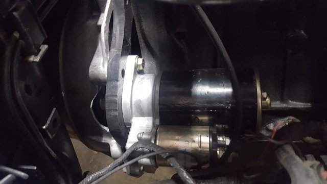

ihiryu Posted February 2, 2016 Share Posted February 2, 2016 (edited) I have sold a few colin's kits. Nothing for RB to VQ though. The adapter piece is nice, but you end up using a bunch of random parts. You use the release bearing sleeve from a v6 200sx,and the VQ release bearing. Shifter is definitely the hardest piece of the puzzle. Plus it takes a few weeks before you get the parts. EDIT: I've ordered two 2jz kits, and one 1uz kit. But I'd imagine it would be the same stuff for the RB stuff. Edited February 2, 2016 by ihiryu Quote Link to comment Share on other sites More sharing options...
Arif Posted February 3, 2016 Author Share Posted February 3, 2016 Thanks for the heads up on the adapters. I emailed them today and got a list of the parts I will need to be able to run the 350z or 370z transmission. Looks like I'll have to fabricate the transmission mount and shifter bracket. He did say that I could use the flywheel and clutch for the RB26. I was going to use a Southbend z31 clutch. Hopefully that will work because I hate selling new parts. Quote Link to comment Share on other sites More sharing options...

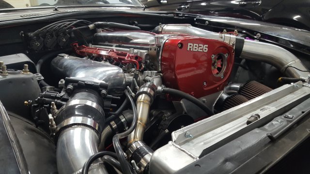

Arif Posted March 3, 2016 Author Share Posted March 3, 2016 All the way from Australia! The RB30 has landed. Now to get the head off the RB26 and freshen everything up. I plan to get the rings and bearings replaced along with getting a valve job on the head and a crank collar pressed on. Then swap all the ancillary parts I had already bought for the RB26 such as the Nitto oil pump and OEM water pump. I had to order the timing belt from England and the crank collar from Australia. Hopefully they'll be here next week. While everything is at the machine shop I'll be able to clean and paint the engine bay. Still pushing for it to be ready this summer. Quote Link to comment Share on other sites More sharing options...

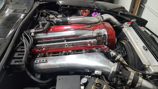

Arif Posted March 18, 2016 Author Share Posted March 18, 2016 A few shots with the air damn mocked up. Nothing is permanently bolted on obviously. Quote Link to comment Share on other sites More sharing options...
