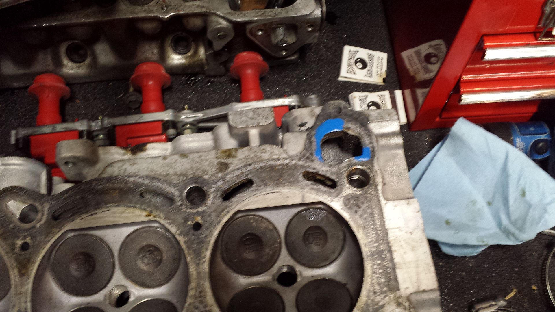

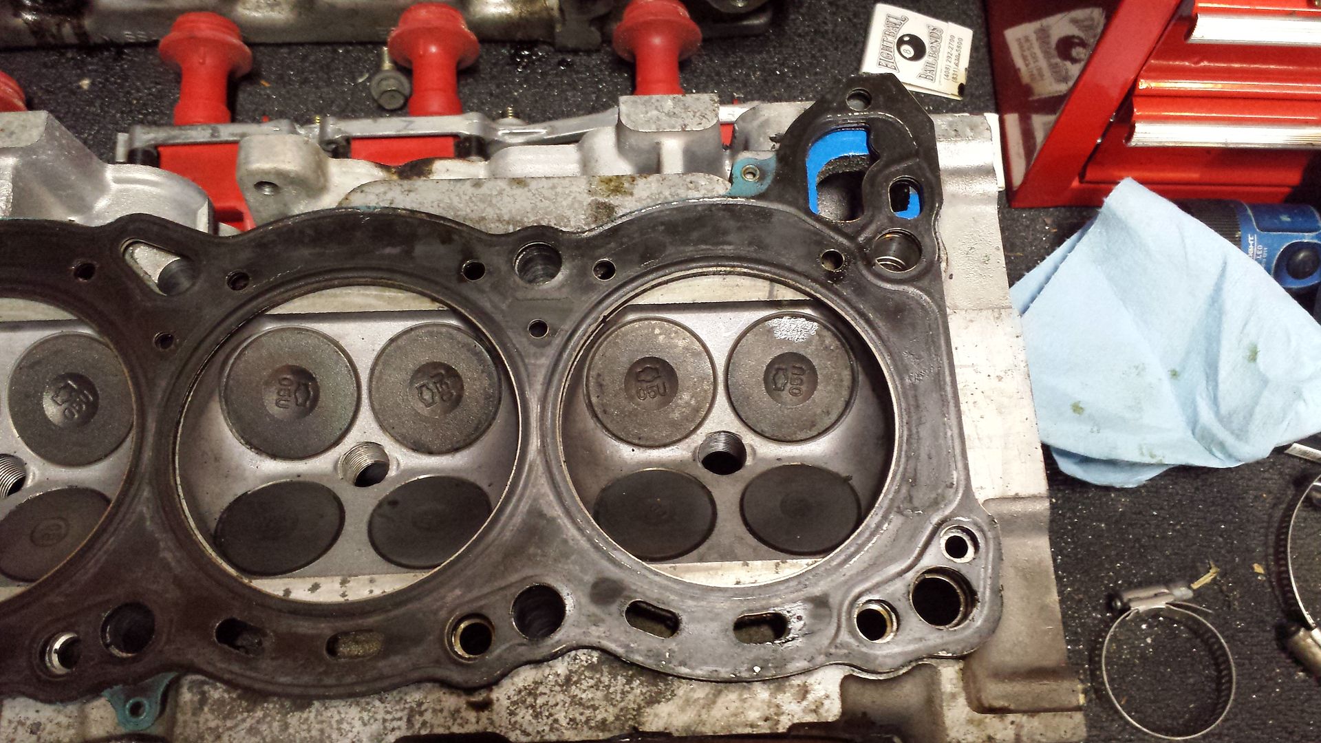

Dont worry about the head bolt size as the alignment dowels are the same size. The front coolant passage is a different shape due to the VCT oil feed being in it on the RB25. I put an RB26 head on an older RB25 from the R32 and it bolted on. The 10mm head bolts will be strong enough to handle any power that the block and pistons can put out. Dont worry about the 1mm gap in the hole as the dowels will locate the head for install and the clamping force will hold it in place. Many people put the 25 head on the 30 block which is the same in reverse as to what you are doing. Some I have talked to have said you can simply have a plug machined for the oil passage and drive it into the hole to block the oil feed for the VCT. The coolant passage is close enough to not cause any leaks.
Not really sure which one would be any better considering that either one would match up to the head or the block. You might have to fudge the coolant passage seal with some RTV. One of the mechanics I knew in Okinawa said that if you use the 26 head gasket, all you had to do is put some RTV over the oil supply and the gasket would be over the hole and be enough to seal it.
I currently have an endyn prepped rb26 head on my rb25.. it was easy.. I had the front coolant passage welded and reshaped..I tapped the vct hole and grub screwed it shut.. I used 11mm (stock diameter) rb25 arp head studs.. dowels are the same size.. I haven't had any issues... been together a little over a year like this
