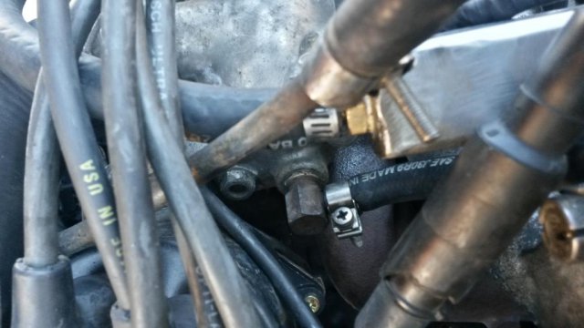

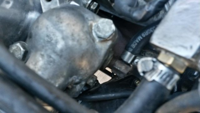

Milenko2121 Posted November 12, 2013 Share Posted November 12, 2013 Been trying to figure out the fitting on this waterneck for awhile, but can't find documentation on it. It's the L shaped fitting. I'm trying to delete it, and put my electronic fan temp sensor here, but I need to know the size before I can pull it out. Thanks, Mil Quote Link to comment Share on other sites More sharing options...
BluDestiny Posted November 12, 2013 Share Posted November 12, 2013 Why can't you pull it out and measure it? Quote Link to comment Share on other sites More sharing options...
Akira Posted November 12, 2013 Share Posted November 12, 2013 Been trying to figure out the fitting on this waterneck for awhile, but can't find documentation on it. It's the L shaped fitting. I'm trying to delete it, and put my electronic fan temp sensor here, but I need to know the size before I can pull it out. Thanks, Mil 20131110_134825_Richtone(HDR).jpg20131110_134814_Richtone(HDR).jpg On my 75 280z, it was 1/4" BSPT (British Standard Pipe Thread) Quote Link to comment Share on other sites More sharing options...
blue72 Posted November 12, 2013 Share Posted November 12, 2013 Can you get a micrometer down there to measure the thread OD? I Google'd around a couple weeks ago and found a chart that had fitting sizes based on the thread OD. Akira is also correct that the pipe fittings on Z cars are all BSPT from the factory too. Quote Link to comment Share on other sites More sharing options...
