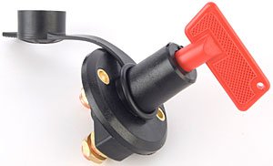

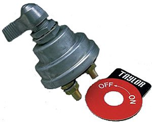

RebekahsZ Posted January 19, 2014 Share Posted January 19, 2014 After the rollbar is done, the next step is to do the electrical safety stuff. I have seen several different kinds of cockpit mounted electrical shutoff switches. For NHRA spec I am required to have a cutoff switch mounted on the back of the car that has a permanent (non-removeable) cutoff handle. I have that done. NHRA does not require a cockpit mounted electrical cutoff switch, but several of you have advised me to install one anyway, so I am going to. But which style switch do you recommend? See photos and give recommendations. Thanks. Quote Link to comment Share on other sites More sharing options...
JIM73240Z Posted January 19, 2014 Share Posted January 19, 2014 I have the one on the right mounted not in the cockpit but on the main hoop right behind my head. I can easily hit it from inside the car strapped in. jimbo Quote Link to comment Share on other sites More sharing options...

RebekahsZ Posted January 19, 2014 Author Share Posted January 19, 2014 Beerman-that would be the one on the left. That is my plan, and I already have one purchased. I have been kind of thinking that it would be safer to use a switch that has a handle that is retained by a screw, as opposed to one that just has a little keyway holding the handle in. Is it perhaps for theft prevention that I see so many of the type on the left in pictures of race cars? Perhaps the owners of those cars turn off the power and take the little red key-handle with them?? Quote Link to comment Share on other sites More sharing options...

beermanpete Posted January 22, 2014 Share Posted January 22, 2014 We have the same (Moroso) switch on our Z. From what I have seen at the track there are many red handles. Most have the handle tethered to the car so it cannot get lost or separated from the car. Quote Link to comment Share on other sites More sharing options...
