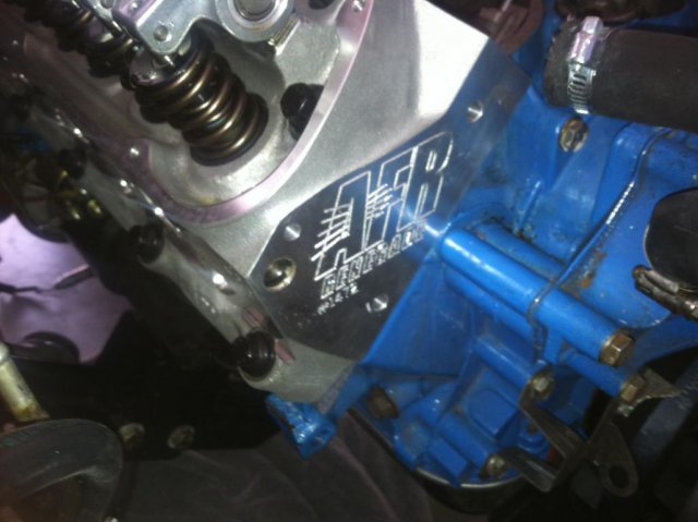

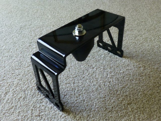

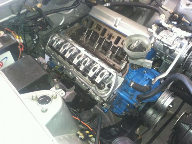

whatnow123 Posted April 30, 2015 Author Share Posted April 30, 2015 (edited) Just another update.Decided that I needed a bit more "Cow Bell", you know, "I got a fever and the only prescription is more cow bell".. Anyway, my Cow Bell is in the form of some AFR 165cc aluminum heads. The stock heads for the 5.0 HO mustang motor are the choking point, followed by the intake and exhaust. The exhaust and intake are already taken care of, so I thought I'd go with some aluminum heads for the weight savings not to mention they are rumored to be the best all round head for the 5.0. Well, they are correct and did it wake up my Z!!! I also installed a rear pinion snubber by Technoversions. Didn't think much about the rear diff moving until I was chasing down a slight vibration I had at 80+ (turns out it was the driveshaft angle and I had to shim it up 1/4 of an inch). Anyway, I installed a web cam under the car to see if I could see the vibration at the pinion and I bet the front of the pinion moved 3 inches up on acceleration. Best 80 bucks I have spent on the car! It just takes right off with out the "softness" if that makes sense. Try one and you'll know what I'm talking about. To bad it's next to impossible to see my shiny new heads with all the EFI stuff in the way. Other than that, just been Zooming around enjoying the car! Edited April 30, 2015 by whatnow123 Quote Link to comment Share on other sites More sharing options...
