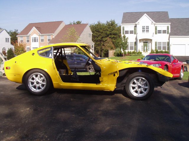

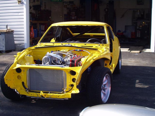

cooperma Posted February 5, 2014 Share Posted February 5, 2014 Posted this before here (It ended up in the 240 area) Just joined the board, I have a 71 240 that is about 40 hours from fully rebuilt from ground up. Well, I got a wild hair and now I want to LS1/2 it. I have a few questions to start: Who has a 71 and used the LS1 and 700r4 tranny or what auto tranny did you use?. How did it fit, what did you have to do to make it fit? Also, what are you all doing for gas tanks. Who has used a fuel cell, what manufactuer and size, and what did you have to do to make it fit (Cutting and cage to sit in) Thanks in advance! BTW, here are a few pics of the Z as it sits, Mark 1 Quote Link to comment Share on other sites More sharing options...

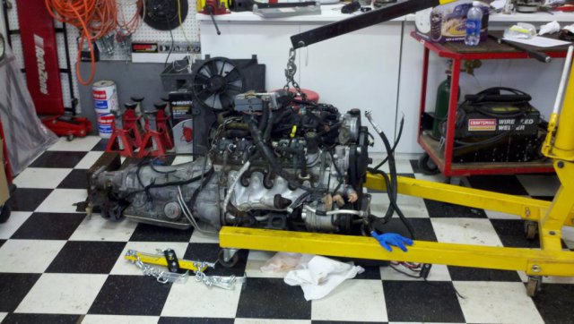

Mikey303LSZ Posted February 9, 2014 Share Posted February 9, 2014 (edited) I have a few questions to start: Q: Who has a 71 and used the LS1 and 700r4 tranny or what auto tranny did you use? A: I have a '73 240z with an LS1 and 4L60E. The 4L60E is the same size as the 700R4 except it is controlled electronically via the PCM (computer). I've owned both (past cars and projects) and would not put a 700r4 behind an LS engine. The 700 requires a TV cable and if not adjusted properly will smoke the transmission within a short period of time. Q: How did it fit, what did you have to do to make it fit? A: The 4L60E fits good in my '73. I had to massage the floor boards a little to allow room for 2.5" exhaust to flow around the trans pan (the trans pan is wide). I also massaged the trans tunnel on the RH side to allow a little extra room near the trans servo. Nothing too major just used an air chisle, a ball peen hammer and a rubber mallet. I also tweaked the JTR trans support bracked to allow more room for the exhaust. Q: Also, what are you all doing for gas tanks. A: Stock tank modified with a larger outlet and larger return line. The guy who modified the tank charged me ~$225 and sealed it too. I have yet to fire up the car yet to see how the stock tank works for me but according to others it should work fine for what my goals are. This is the 4L60E valve body - it has a wire harness to control solenoids for the shifting. This trans requires a PCM (computer). This is the LS1, trans and PCM from a 2002 Z28. You can use the 12" floor tiles for size reference. Edited February 9, 2014 by Mikey303LSZ Quote Link to comment Share on other sites More sharing options...
