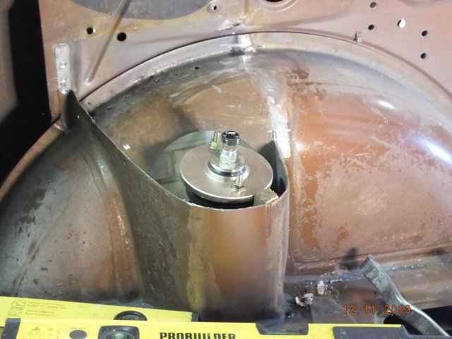

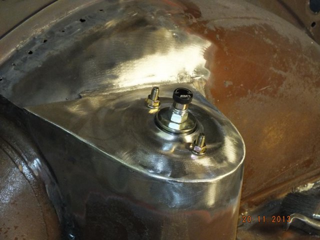

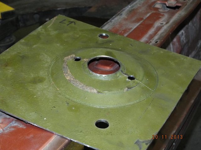

TUME Posted October 13, 2016 Share Posted October 13, 2016 Agreed, go with S14´s. MIne is S13´s and I had to cut down strut tower. Also made new hat on it, so i get those S13´s upper mounts to suite. It´s worth to ask, if they (BC) swap upper mount´s. I get mine with Z32 bottom mount by just asking. Quote Link to comment Share on other sites More sharing options...

TUME Posted August 30, 2017 Share Posted August 30, 2017 As i say, i went to S13 coilovers. It´s probably not an easiest way to go. Look at these pics and my previous post. Quote Link to comment Share on other sites More sharing options...
