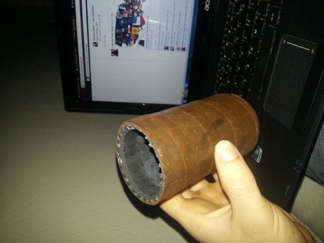

alexx933 Posted February 18, 2014 Author Share Posted February 18, 2014 (edited) The turbo hose isn't your typical silicone coupler. Sorry if the picture is a rediculous size, but hopefully you can get a grasp of what I meant. So you'd trust this kind of coupler right next to your turbo?? Edited February 18, 2014 by alexx933 Quote Link to comment Share on other sites More sharing options...
softopz Posted February 18, 2014 Share Posted February 18, 2014 I would that's too that thick though. And I wouldn't use those regular silicone couplers for intercoolers most of the ones I seen are too thin. Go a diesel turbo shop I'm sure you can find something sturdy yet not as thick. Remember stock turbo get pretty tight there especially at the clamp and oil line.Also the stock jpipe has a cool double clamp that holds on both ends its much more stable than having two separate clamps. If you don't find anything I believe I have an nice hose for you if you want cover the shipping and wait its yours for free. I think I have the double clamp too. Quote Link to comment Share on other sites More sharing options...
alexx933 Posted February 18, 2014 Author Share Posted February 18, 2014 The eBay one is too thick? I didn't think that would be much of an issue. I may end up taking your offer softopz. I'll pm you if I can't find something. Quote Link to comment Share on other sites More sharing options...
Xnke Posted February 20, 2014 Share Posted February 20, 2014 (edited) Yeah, I'd run that if I could get it on the turbo. It's ugly as sin but I doubt that it would cause problems. It's not silicone, however; it looks like a rubber hose, braided liner and some kind of wrapped outer. What you don't want is the non-braided type...it'll expand and break. Ideally you'd want a braided, 3 or 4 layer, silicone hose. The shorter the better. EDIT: just followed your link. I run those silicone couplers on my own car; they seem "thin" but they have four layers of braid in them and on a few cars we've used them on they've held 18PSI without issues. You won't likely "blow" any braided-layer, silicone, coupler, even on the turbo outlet...more likely if it's a bad coupler it'll blow off, slipping out of the clamp. Edited February 20, 2014 by Xnke Quote Link to comment Share on other sites More sharing options...
alexx933 Posted February 21, 2014 Author Share Posted February 21, 2014 I wish that ugly brown tube would have worked but the ID was slightly too small and wouldn't slip on at all. I ended up ordering a 4 ply woven aramid reinforced turbo hose which has an ID of 2 inches and length of 4 inches. That's fairly long but the turbo and j-pipe should slide right up to each other. I'll just make sure and clamp them down hard. Once again, thanks for the help! Maybe this will resolve some of the issues I've been having! Quote Link to comment Share on other sites More sharing options...
