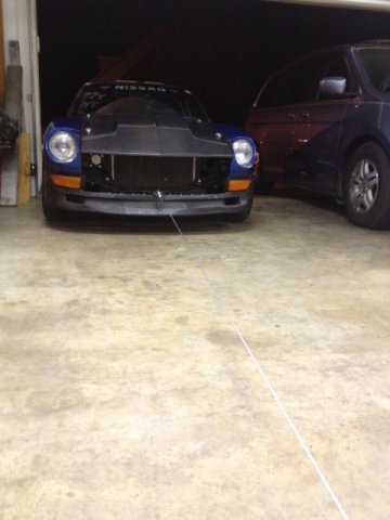

RebekahsZ Posted April 24, 2014 Share Posted April 24, 2014 (edited) I'm ordering urethane brake ducts to bond to the back of my urethane airdam. Anybody have a recommendation for a super good adhesive? If so, any recommendations for prepping both surfaces prior to bonding? Pics of airdam and ducts attached. Edited April 24, 2014 by RebekahsZ Quote Link to comment Share on other sites More sharing options...
OldAndyAndTheSea Posted April 24, 2014 Share Posted April 24, 2014 (edited) G flex is a 5 minute epoxy that I used in the composites shop frequently. I feel it would be more than adequate in what you'd like to do. Clean. Acetone wipe. Surfaces prepped with 180-220 grit. Edited April 24, 2014 by OldAndyAndTheSea Quote Link to comment Share on other sites More sharing options...
RebekahsZ Posted April 24, 2014 Author Share Posted April 24, 2014 Andy-I smack my airdam pretty often on driveways and on my trailer-is that 5-minute epoxy flexible at all? And I know thus is stupid, but do I acetone before sand it or after sanding? Quote Link to comment Share on other sites More sharing options...
310z Posted April 24, 2014 Share Posted April 24, 2014 You could also add a few pop rivets. Quote Link to comment Share on other sites More sharing options...
OldAndyAndTheSea Posted April 24, 2014 Share Posted April 24, 2014 Yeah, I find it to be. .Also, Id suggest adding a colloidal silica while mixing to form a nice peanut butter consistency. And Sand 150-220 --> Acetone Wipe --> (Clean) --> Mix equal parts G flex (then add colloidal silica) --> Quickly apply items. The stuff works quickly, and from experience, if you waste a lot of time mixing the silica you'll be pressed for working time with the mateiral. But it's stupid strong. Very resilient, and from what I can tell very impact, and vibration resistant. Quote Link to comment Share on other sites More sharing options...

mattb3562 Posted April 24, 2014 Share Posted April 24, 2014 I'm sure Andy's suggestion is a great. An alternative would be 3M panel bonding adhesive or 3M urethane used for glass. It is very flexible and readily available at local parts store. I have used it for many air dam/chin spoiler installs and it works great. The biggest benefit to it is that if the moulded part doesn't butt up perfectly, you can use it to produce up to a 3/4" gap that will adhere both sides. Quote Link to comment Share on other sites More sharing options...

tecreatta Posted April 24, 2014 Share Posted April 24, 2014 I use 3M panel bond 8115. It'll rip the urethane parts before the bond breaks. Quote Link to comment Share on other sites More sharing options...
