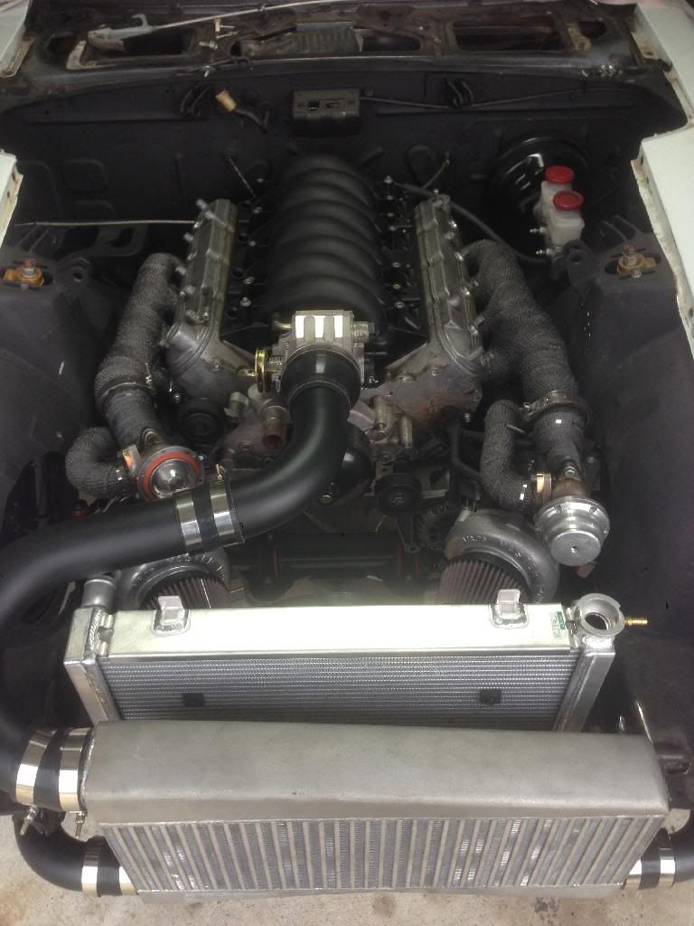

thezguy Posted May 10, 2014 Author Share Posted May 10, 2014 (edited) Rebekah, Your post made me laugh a little bit.. rest a sure than many many many modifcations from brakes/chassis/motor have been made to this car. this is an earlier photo and yes i did all of it. Edited May 10, 2014 by thezguy Quote Link to comment Share on other sites More sharing options...

RebekahsZ Posted May 10, 2014 Share Posted May 10, 2014 Holy smokes! You ain't kidding! A picture is worth a thousand words. I stand corrected and humbled. Crow tastes good with my morning coffee. Post up more pics ASAP. Looks like we got started off on the wrong foot. Please accept my apologies. What would it take for you to go straight axle and then you will be perhaps done with your drivetrain instead of doing and re-doing like I have done? With that powertrain I would try to go straight to a 33spline 8.8 or 9". I am finding that I am axle-limited at 400hp. And SunnyZ and I have had trouble with the sheetmetal around the nose of the diff. Surely you don't plan to have ALL THAT and not use it?? Quote Link to comment Share on other sites More sharing options...
