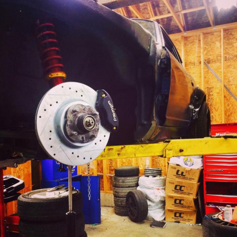

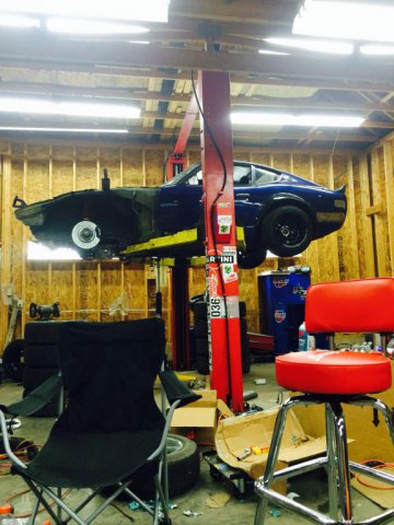

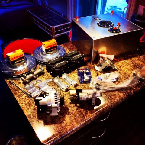

B5BiTurbo Posted April 13, 2015 Author Share Posted April 13, 2015 Couple more things to install. Wilwood kit, aeromotive fuel cell/pump, couple accessories. (Troubles with alt explained in previous post) Yesterday I got my brakes on but that's about it :/ Quote Link to comment Share on other sites More sharing options...

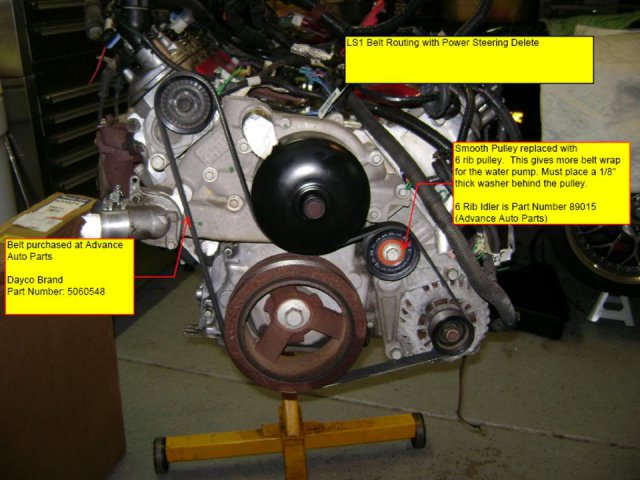

mistafosta Posted April 18, 2015 Share Posted April 18, 2015 http://www.scramspeed.com/products/lsx-billet-water-pump-spacers-for-ls1-camaro-truck-and-ls3-vette-ls1-swap.html I use those, but check ebay, Scram Speed sells on there with free shipping. Its a very nice piece, also I use the factory captured oring style gaskets since I HATE paper gaskets. You will need to use a LS3 corvette style belt tensioner as well, since that is spaced correctly. Its about $120 all said and done, but works great. Then you can just use an idler pulley instead of PS if you want, and it works perfectly! Quote Link to comment Share on other sites More sharing options...

mistafosta Posted May 6, 2015 Share Posted May 6, 2015 Also the tensioner I used was the stock 2004 vette tensioner which fits the belt spacing with the spacers. As for the idler, in that picture of the belt routing, there is the part # from autozone for it. You will need to use a washer to space it correctly as it says in the picture. Quote Link to comment Share on other sites More sharing options...
