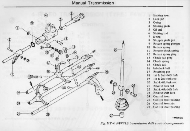

NewZed Posted May 24, 2014 Share Posted May 24, 2014 Probably the shift fork. Quote Link to comment Share on other sites More sharing options...
Shakey Posted May 24, 2014 Author Share Posted May 24, 2014 But would a defective shift fork affect just the 3rd and 4th gears? Quote Link to comment Share on other sites More sharing options...
NewZed Posted May 24, 2014 Share Posted May 24, 2014 Are you on a phone? There's a picture in Post #2. Pretty self-explanatory. Quote Link to comment Share on other sites More sharing options...
Shakey Posted May 24, 2014 Author Share Posted May 24, 2014 Sorry for misunderstanding. Thought he was referring to a clutch fork. Referring to the diagram I see what may be the problem. Thanks. Quote Link to comment Share on other sites More sharing options...

Shakey Posted May 26, 2014 Author Share Posted May 26, 2014 Found the problem. Roll pin holding the fork. Thanks to all. Quote Link to comment Share on other sites More sharing options...
