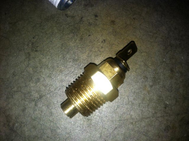

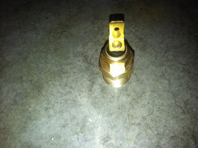

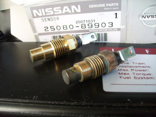

I'm hoping someone has an answer to this. Is there a compatible temp sensor that will work with a 280z temp gauge for my engine swap?
I meant to keep the temp sensor and oil sensor when I pulled and sold my engine but forgot to pull them off before the engine left. I can't seem to find a water sensor for the 280z (the parts store only list the 2 wire sensor for the EFI harness).
I did a Ford v8 swap but can't find any specs on the 280z sensor to see if I can find a ford sensor that is close to the ohm readings...
Anyone know of a sensor that will work?
Thanks!!
Edited by whatnow123
Generally an 'adapter bushing' is required anyway going from JIS to NPT threads... Just use Loctite PST 765 or so, and not tape so it makes a good metal-to-metal contact when you screw it in and gives a good ground path so you don't get 'gauge skew'.
