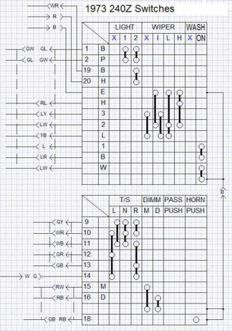

I've done quite a bit of searching, but have not come up with an answer to this... I have a 73 240, I have the factory service manual, as well as the downloadable version that someone was nice enough to post on a different site. Here's my questions: The FSM wiring diagram for a car with a manual transmission (page BE-5) shows Fog Lamps, which I understand was not a U.S. option, so I am not surprised to find no wiring for them in my car, but the diagram also shows "step lamps" (right and left hand), which I can't find any evidence of my car having. I am assuming that these were not a U.S. thing either.  I am wondering what else this wiring diagram is showing me that does not exist on a US spec car. Does anyone have any insight on this? Here's another thing, I am trying to decipher what the diagram is showing me for the combo switch/turn signal switch. My manual is a little blurry on some parts of that "chart". I have redrawn it (see attached graphic) with the questionable bits in red, and I put blue X in place of the word "off" (since the word was too long to fit in my graphic). Also, does anyone have any idea what the numbers in the left column are for. I'm thinking the letters in the second-to-the-left column must relate to things like H=high, L=low, I-intermittent, etc. but some of those letters are not making sense to me.

Hi Dom, thanks for the reply. I agree that the numbers could relate to connectors, but in looking at the connectors on the turn signal/high beam switch even using a magnifying glass, I don't see any numbers on the connectors themselves. Besides, some of those numbers are associated with a wire that just has a single "bullet" style connector and isn't part of a larger multi-pin connector. Still, perhaps it relates to the other end... those 10-pin connectors in the passenger area? As far as the letters go... E=earth makes sense since this is a black wire. I'm really stumped on the M and D on the turn signal/high beam switch. And if anyone can correct or confirm the HIGH PUSH PUSH in red in the jpeg That would be a big help.
They are pin designations, there  was a section somewhere to show you how to determine pin position... something using the locating tab up, then top left to right, then next lower row left to right, etc....
That is a nice redraw. Definitely something worthwhile to be sure! I got a real manual and they're blurry!
Hey guys, I could buy the numbers=pins if the numbers and numbers-of-pins agree. I just don't see how you could have a pin 11 on a 9 pin connector. In my 30 years as a design draftsman (many of them doing schematic work), I have never seen electrical connectors have pin numbers that were totally off from the pin count. I have seen connectors use letters, numbers, and combinations of letters and numbers, but never arbitrary numbers. According to the wiring diagram and the body harness drawings, the largest connectors we have in these cars only have 10 pins (at least on the 240). Therefore there should not be any "number 11" or higher (the way I see it). That's why I put the shout out for help, because what's in the FSM just isn't making sense to me. Perhaps I am trying to read too much into these numbers, and they were just meant for some sort of internal Nissan technical document, and not for us "owners". Page BE-19 in my manual shows the windshield wiper/washer schematic in more detail, and there are numbers (1, 2, 3) and letters (W, L, H, E, B, P) that I can see corresponding to the attachment in my original post. (W= Wash, L=Low, H=High, E=Earth (ground))... But what do B and P stand for :huh: ?
Then there is the turn signal/high beam switch. For the turn signal column, I figure L=Left, N=Neutral (centered), R=Right.
The "DIMM" column is for the high beams, I am thinking M=Maximum (high beams on), D=Drive (normal headlights). This is based on following the RW wire that is associated with M up to the speedometer where it looks like it is connected to a lamp (high beam indicator?). I think the "PASS" column may be referring to a JDM or Euro spec car that would have a momentary "flash to pass" feature found on newer cars, but since our US spec cars only have a pull-click-on/pull-click-off high beam switch we don't have any dots in this column. (But if they were going to do a U.S. specific wiring diagram why didn't they remove the fog lamps and step lamps from the diagram? :angry: ) That last column that I have labeled "HIGH" in red I now think should be "HORN". If you follow that GB wire it ends at the horn relay. Seeing as the physical switch does include the horn conductor that contacts the center pad, I guess I can see why they included the horn into this diagram.
Hey Tony, I found in my FSM the wiring diagram for the automatic equipped car is less blurry than the one for the manual transmission. Perhaps yours is the same? I hope I didn't come across sounding like an argumentative SOB. That was not my intent! I really appreciate all those who take the time to read the post and offer suggestions. So Tony and Dom, thank you very much for your input. Perhaps we can get this sorted out so that when others browse this topic looking for answers we can have something solid for folks to refer to.

Pin 11 does not mean you are looking at a connector with more than 11 pins to find pin 11 . Look at the whole picture , they are more than one connector . For example , a 6 pin connector is labeled 1-6 and a 4 pin connector is labeled 7-10 , so pin 10 is located in 4 pin connector . Hope that help . That's just how they did it .
Tony, you have probably hit the nail on the head with it being a translation issue. Although, I was looking at the '74 wiring diagram for the headlight circuit, and they actually label the high beam indicator lamp as the "Main Beam W/Lamp" and the high beam switch as the "Turn Signal Dimmer Switch". Which leaves me wondering if the Japanese normally drive with their high beams on all the time, and occasionally "Dimm" them for the oncomming traffic. So I'd say at this point that M=Main (high beam) and D=Dimm (Low Beam). I have looked in the FSM for the pin numbering explanation, but haven't found it. What page is it on?
Dom, I think you are probably right... it's total pins all together and not per connector. P seems to energize the dash lights if I'm reading this blurry mess correctly (or is it my eyes are just crappy?). The top B traces to the under-hood inspection lamp, the other B traces to the map lamp, so yeah, perhaps it does corrospond to BATT+.
The only question I have left now is my red "H" in the combo switch. I *think* it may actually be a B from looking at the '72 wiring diagram, but it may also be an E. It's really hard to tell because my manual and the down-loadable PDF's are all kinds of blurry in that area of the chart. Does anyone out there have a better copy?

OK, I found on pages BE-22 and BE-23 a nice description of the combo and dimmer switches, and it answered my question regarding the red H... it is a B after all. I have updated my diagram, and am attaching here for everyone to use. Blue X = "OFF". You may notice that some connections show two different wire colors, (numbers 1, 2, and 14). This is not based only on the FSM, but rather what is in my car as well. I have several electrical issues with this car, so I figured I'd start my own wiring diagram to document what I have, and then compare that to what is in the FSM. Between the missing stock (and aftermarket) radio, the missing dealer installed AC, and the interesting anti-theft "hidden button that must be pressed" to start the car (that the original owner put in, then my brother bypassed, but left in place), not to mention 40+ years of wear and tear, corrosion, etc. it's little wonder that I'm having some issues. In fact, I'm kind of surprised I'm not having more issues than what I have!
