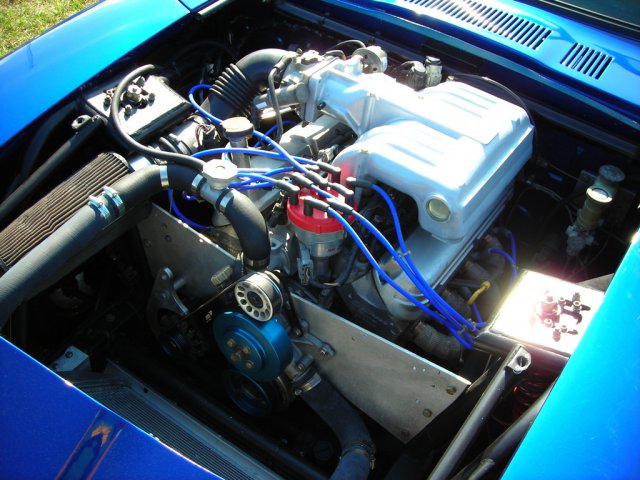

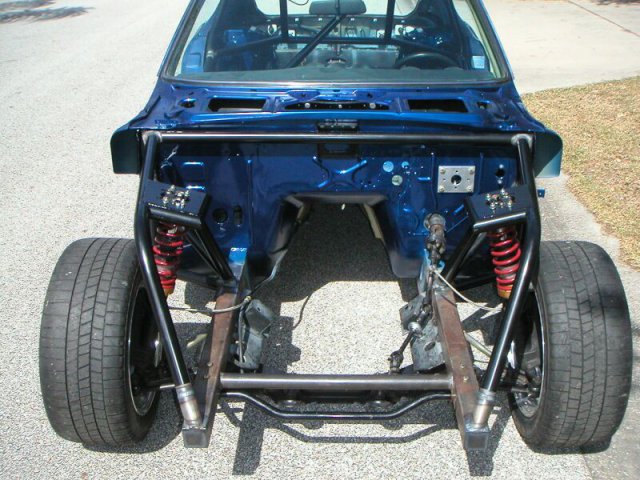

74_5.0L_Z Posted July 31, 2014 Share Posted July 31, 2014 (edited) I deleted my booster about thirteen years ago when I went to four wheel disc brakes. All the it takes is a plate that has the master cylinder bolt pattern superimposed on the firewall bolt pattern, and an appropriate pushrod/clevis going into the master cylinder. I used the stock 260Z master cylinder with my set-up. I believe that it has a 15/16 bore. I autocross the car frequently, and I love the feel of my brakes. So, can you delete the booster? The answer is yes. Should you use a single circuit master cylinder like used on the kit shown by the original poster? Hell No! My entire brake system is as follows: Front: 11.75 x 1.2 vented rotors Outlaw 2800 calipers with 1.75" pistons Hawk HB237N.625 Pads (HP Plus compound) Rear: 10.75 x 0.81" vented rotors Outlaw 2800 calipers with 1.375" pistons Hawk HB237N.625 Pads Wilwood proportioning valve Stock Pedal Assembly Stock Master Cylinder With good components front and rear and good brake balance, there is no need for a brake booster on our cars (IMHO). To me, the booster is only an extra source of weight and an extra item that can fail. The pictures below show the aluminum plate that I used to delete the booster. The first picture shows the plate on the firewall, and the second shows the master cylinder installed. Note: Edited my brake set-up inventory. I thought I had used the 1.25" pistons in the rear, but I was wrong. I installed the 1.375 pistons on the rear thirteen years ago. The memory just isn't what it used to be.... Edited August 2, 2014 by 74_5.0L_Z Quote Link to comment Share on other sites More sharing options...
