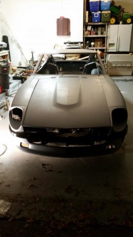

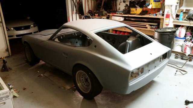

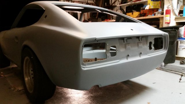

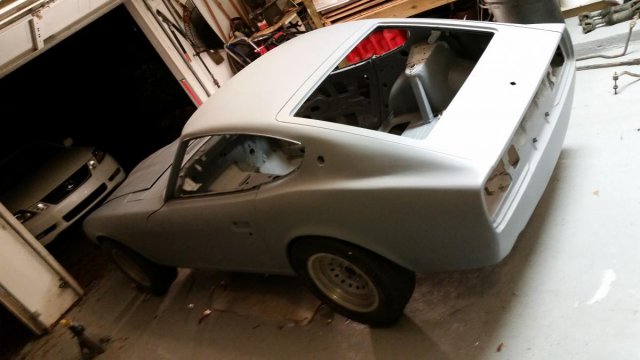

Eddie 1979 Posted December 30, 2014 Share Posted December 30, 2014 ...alright..seriously. No words of encouragement or criticism? I've dropped a Celine Dion & Dexter reference, put my pics of my new P1 up (it's actually not mine) and the build is a full ground up resto with RB swap from a guy who's never touched a car. Tough crowd. Looks good! I'm going to be knee deep in epoxy primer soon enough, taking a little different approach though since I'll be sanding and spraying one panel at a time. Did you find that the makeshift booth was helpful? How critical did you find the dust free environment to be at the priming stage? Quote Link to comment Share on other sites More sharing options...
quickdraw Posted December 30, 2014 Author Share Posted December 30, 2014 Looks good! I'm going to be knee deep in epoxy primer soon enough, taking a little different approach though since I'll be sanding and spraying one panel at a time. Did you find that the makeshift booth was helpful? How critical did you find the dust free environment to be at the priming stage? In hindsight, it was probably overkill. It only took a couple hours, a $25 roll of plastic, and duct tape but for me it ended up cramping the working space and I block sanded regardless. It did keep the rest of the garage from getting painted. Which is nice. But I'm not sure I would do it again. Probably just paint it outside on a clear still day. Quote Link to comment Share on other sites More sharing options...

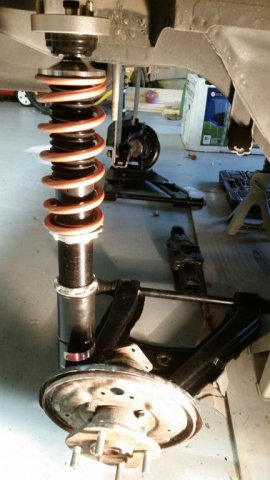

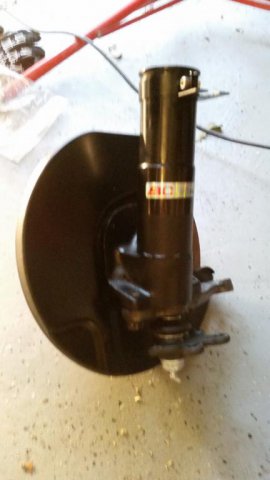

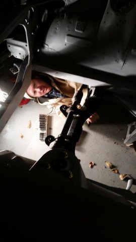

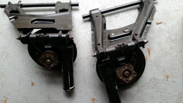

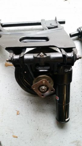

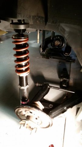

quickdraw Posted January 18, 2015 Author Share Posted January 18, 2015 Got all of the suspension back from getting welded up. Brand new spindle pins pressed in as well. I cleaned everything and painted all of the suspension stuff. Quote Link to comment Share on other sites More sharing options...

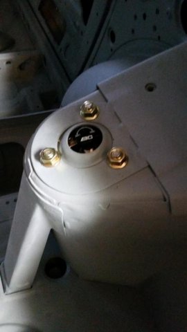

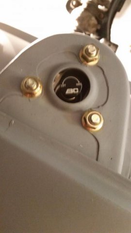

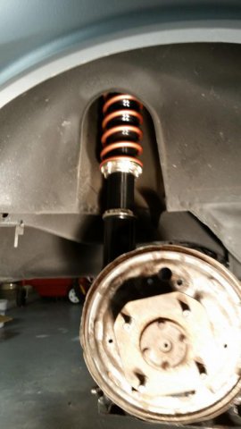

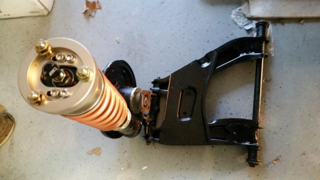

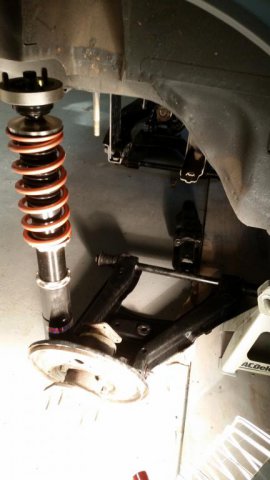

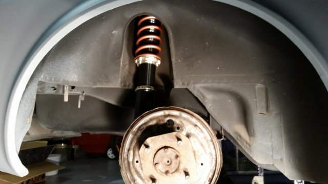

quickdraw Posted January 18, 2015 Author Share Posted January 18, 2015 And everything back up underneath the car. All the suspension was cleaned and painted with new bushings all of the way around. And a BC racing 30-way adjustable coilover set with camber adjustment...yay! ( Quote Link to comment Share on other sites More sharing options...

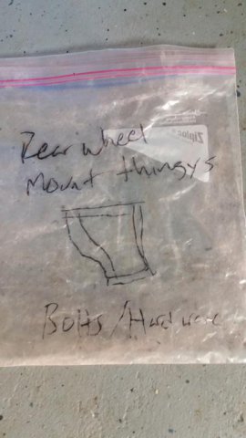

quickdraw Posted January 18, 2015 Author Share Posted January 18, 2015 It's super important to thoroughly label parts when they come off.. Quote Link to comment Share on other sites More sharing options...

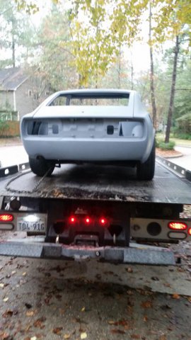

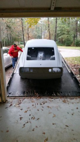

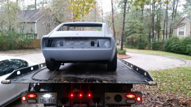

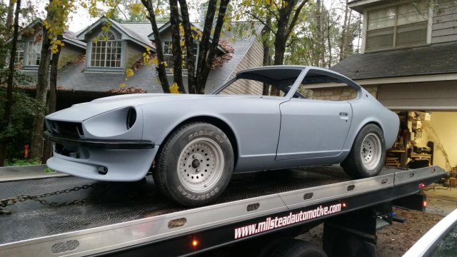

quickdraw Posted January 18, 2015 Author Share Posted January 18, 2015 And finally off to paint. Been a little longer than planned but pretty exciting to get to this point. Quote Link to comment Share on other sites More sharing options...

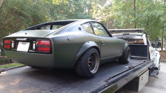

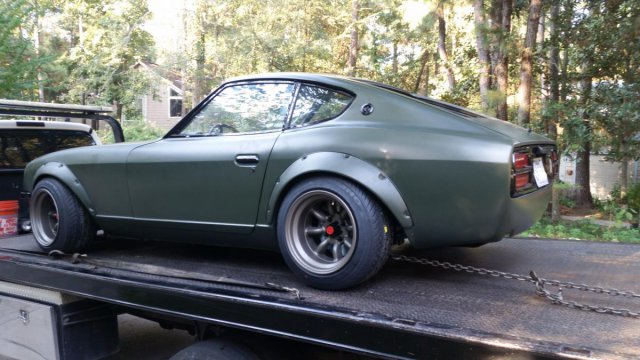

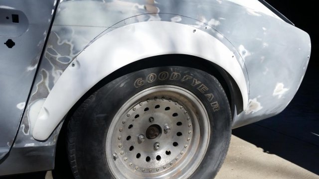

quickdraw Posted January 29, 2015 Author Share Posted January 29, 2015 Would love some feedback on the JPN garage wide flares. The fronts that arrived fit fine. The rears however are too wide at the opening by at least two inches. I contacted JPN and the response was bend them. And they were made that way so people could put wider wheels (which doesn't make sense). And further he checked with the group that made them and they indicated that's how they are and no one has ever complained. Am I losing my mind or missing something with these? Quote Link to comment Share on other sites More sharing options...
stravi757 Posted January 29, 2015 Share Posted January 29, 2015 (edited) bummed to see you are going with flares. ±I really appreciated the work you had done on the the body! hate to see fender chopped But as far as the flares go maybe confirm with someone else about the fitment issue who also bought from jpngarage. But the flares I installed a couple years ago from MSA didnt have the fitment issues you mention to that degree. I had to flex them a little bit, but nothing that was awkward Edited January 29, 2015 by stravi757 Quote Link to comment Share on other sites More sharing options...
RebekahsZ Posted January 29, 2015 Share Posted January 29, 2015 I have held 3 different brands of flares in my hands and mocked them up on my car. Every one of them is too wide(?) in the fore and aft direction. I flexed my current pair to make them fit better and they now have cracks in the gel coat. Flares are one of those things that, at least for now, there are only imperfect products available. Ya need to design and make something better or just live with it like the rest of us. I think they were originally created to just cover the top of the tire for racing rules, and like many racing parts, they are intended to be light, simple and disposable. I doubt that the guy who made the first pair envisioned us paying $400 for a set-he probably made them at 2:00 in the morning the day before a race. At 42 years old, my Z seems determined to self-destruct no matter what I do to delay the process of decay. Car is at metal shop right now having some metal fatigue in the door repaired. I'm going to ignore the cracks in my flares until they fall right off the car. I just hope the screw holes line up for the inevitable replacements. Quote Link to comment Share on other sites More sharing options...
quickdraw Posted January 29, 2015 Author Share Posted January 29, 2015 Thanks. Rebekah z...good point on how we got here but its a bit disappointing to pay for something that could easily be manufactured to fit...oh well. Bend it is Quote Link to comment Share on other sites More sharing options...
