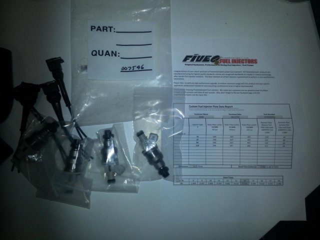

Meguiars Posted September 7, 2014 Share Posted September 7, 2014 Hi, i have just got my car up starting 280z with l28et, 240sx TB, non intercooler, walbro gsl392, Denso 456cc see picture. i have some problems by adjusting the idle so it wont run rich as 9.8 -10.1 AFR it wont pass the emmision control here in Norway. I have tryed to run 2 and 3 squirts simultnouse, but the best result as far as i think is 6 squirts alternating, it felt more snappy on the throttle. Any tips an ideas? i only have the original idle valve on the top of intake, do i have to mount Ford PWM IAC valve. Or can i alter the deadtimes to get leaner idle? This is High imp 11.5 ohm, so i have turned off PW limiting also, right? The deadtime as you see in the picture is 0.616 at 13 volt. Any ideas guys and girls. Thanx Quote Link to comment Share on other sites More sharing options...
dexter72 Posted September 7, 2014 Share Posted September 7, 2014 Have tried putting lower numbers in your VE Tables at idle??.. Have you tried lowering the required fuel ??.. Quote Link to comment Share on other sites More sharing options...
Meguiars Posted September 7, 2014 Author Share Posted September 7, 2014 i have tryed to lower the th ve tab, i can force it down, but still that rich. i have tryed everythong , Quote Link to comment Share on other sites More sharing options...
