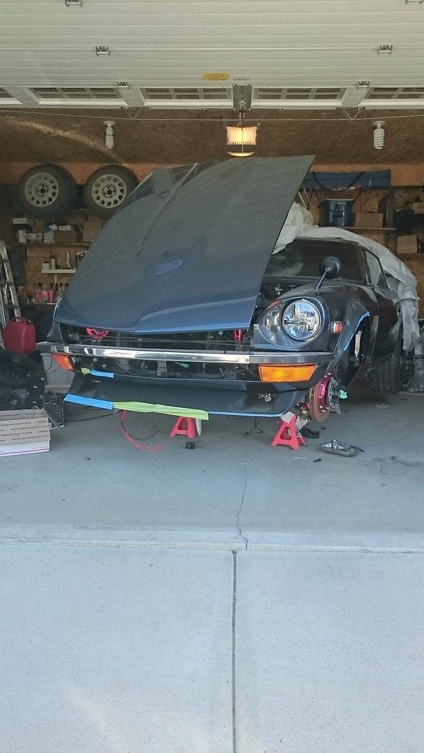

1969honda Posted May 4, 2015 Share Posted May 4, 2015 (edited) I have some TruckLites on the shelf waiting for my build to progress to the electrical upgrade phase of things. I can say they are a direct swap though as I put one in just for kicks and giggles after seeing this thread. I'll post a few pics up a little later of a comparison of how they look cosmetically, the right hand side still has the stock light installed.Interesting side note, almost all new military trucks have trucklites installed, the neawer Oshkosh trucks we are getting appear to have the JWs. Both are really nice and bright at night. Edited May 4, 2015 by 1969honda Quote Link to comment Share on other sites More sharing options...

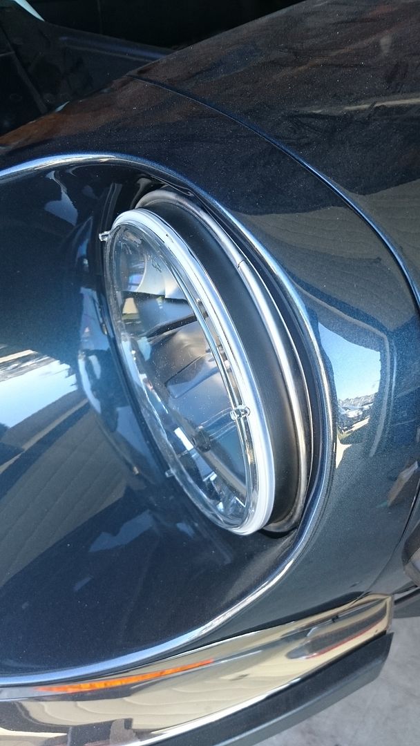

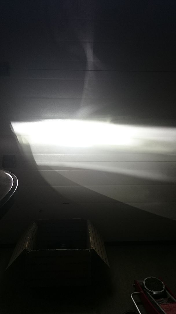

takayuki Posted May 5, 2015 Share Posted May 5, 2015 I have a early 260z. here are some photos that I took: Not a fair comparison since I didn't take the picture from the exact same spot. But as you can see, these are way brighter than stock and probably just as bright as HID's.\ low beam high beam This is where I spliced into to install the relay. I opted to go with this setup because it's a lot more simple than HID's. No ballasts, no addition of fuses, no need to add wires. Keeps it more Tidy. Just had to add one relay. It draws 1.8amps per headlight on low beams and 3.6amps on high beams. A lot easier on your electrical system. Quote Link to comment Share on other sites More sharing options...
