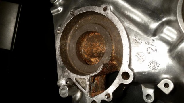

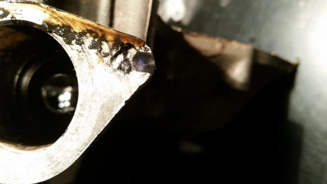

EZ-83 Posted September 28, 2014 Share Posted September 28, 2014 Is it possible to fix either of these timing covers? Any advice? The first one looks like the water pump wouldn't seal right and the second one had an easy out break off in the distributor mounting hole and was then... tortured... Quote Link to comment Share on other sites More sharing options...
Tony D Posted September 28, 2014 Share Posted September 28, 2014 Absolutely, just depends on your capabilities. The corroded pump cover would be my choice to use as no machine work looks to be required. Quote Link to comment Share on other sites More sharing options...
EZ-83 Posted September 29, 2014 Author Share Posted September 29, 2014 On 9/28/2014 at 12:48 PM, Tony D said: Absolutely, just depends on your capabilities. The corroded pump cover would be my choice to use as no machine work looks to be required. How would you advise I go about fixing the corroded pump cover? Quote Link to comment Share on other sites More sharing options...
Tony D Posted September 29, 2014 Share Posted September 29, 2014 Devcon Aluminum or Ceramic Putty after degreasing and media blasting to give proper surface profile. If you don't want to buy another front cover, Devcon saves all. Check out their site on Centrifugal Water Pump Repair Slurry or simply Aluminum Putty. It's machine workable... I watched their Titanium Putty eat up carbide burrs... It's used in general industry all the time... Quote Link to comment Share on other sites More sharing options...
