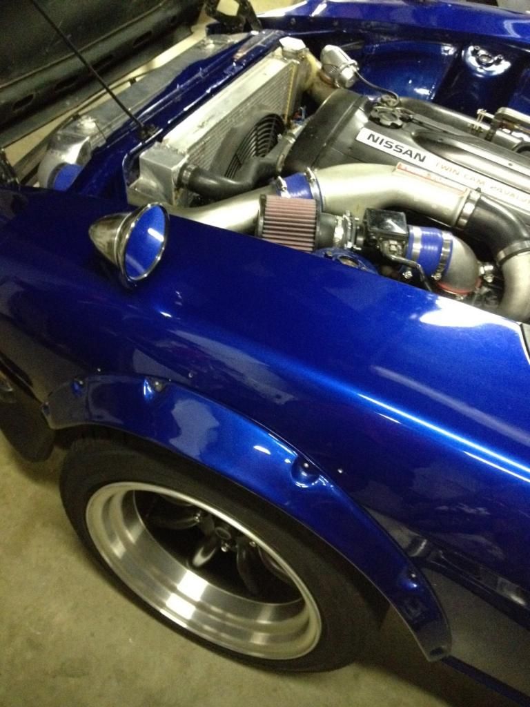

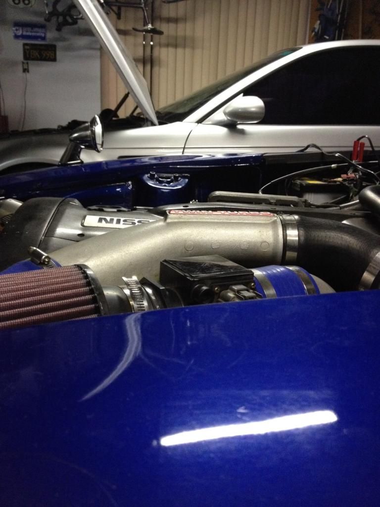

ktown z Posted November 9, 2014 Share Posted November 9, 2014 Here are some pics. Quote Link to comment Share on other sites More sharing options...
