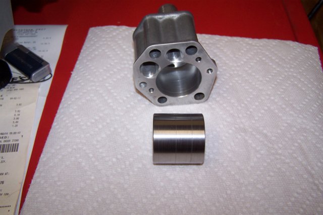

Was verifying that the pressure relief valve in my oil pump was installed correctly today, and after confirming how it is assembled, I really don't understand how it works.  Can someone explain it to me?

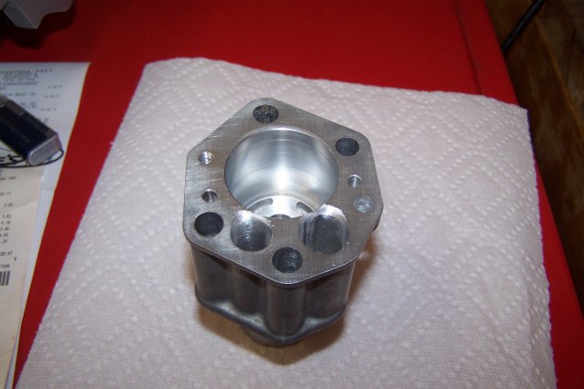

Spring pressure presses the piston against the top of it's bore.
As oil flowbuilds, the pressure is created by friction in oil galleries and orifices (bearing clearances) that restrict that flow. As a result pressure rises.
As pressure rises, it presses on the relief piston face...once this hydraulic pressure total (area of the piston, multiplied by the hydraulic pressure) eventually overcomes the spring pressure.
Spring pressure is rated in "pounds per inch" or other weight-vs-deflection standard.
So as your pressure increases, the spring allows the piston to deflect, at some point the piston will uncover a relief port and bleed off pressure.
This will counteract spring compression when hydraulic pressure drops, and the spring presses back up and closes the port allowing pressure to rise... This balancing act goes on at that preset pressure.
You can see by shimming the spring it will increase spring preload and fluid pressure as a result.
Curiously so will cutting the spring as it can increase spring rate... The shim then merely becomes a placeholder for the installed height you cut out of the spring.
Clear as mud now?
Sometimes the 'needle' on the bore end restricts the inlet to the relief piston chamber, or the relief port making for a smoother response at one end or the other of the regulation spectrum.
Then...you can add relief port friction or size which can affect the relief capability of the port which could otherwise just blow to the oil pan unrestricted. I have seen arrangements where synthetic oil ran dangerously high pressure cold, and dangerously low when hot due to relief port and passage design. The reaction of viscosity can make a big difference in how the relief port dies it's job. Thick oil may jam the piston to the bottom of it's bore, completely allowing full bypass... And kind of removing it as it's intended use in the system...

Thanks Tony.  I follow.  I guess without the relief, if the shaft speed keeps increasing, the oil pressure would become excessive.
I took off the bottom of the oil pump today and saw that that the post on the piston bottoms out on the aluminum casting in such a way as to set the piston top (base of the post) flush with the side of the cavern that oil flows into.  I think it is a "depth" setting thing... so the piston doesn't come out too far.
