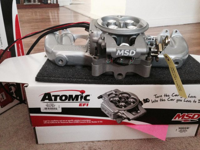

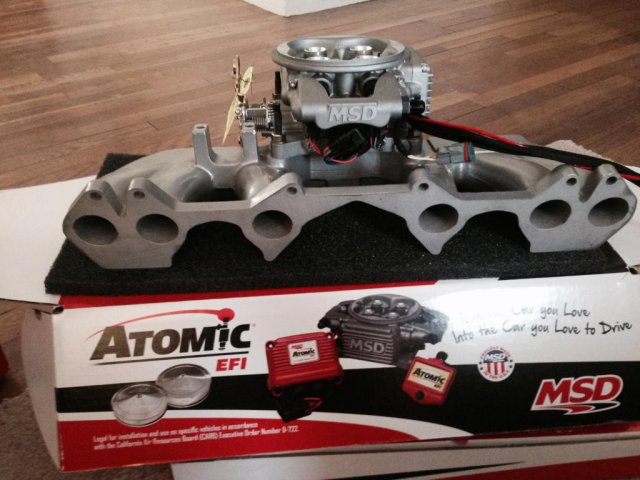

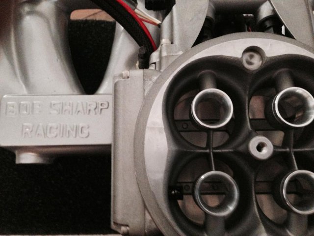

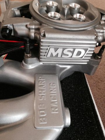

michael wales Posted March 24, 2015 Author Share Posted March 24, 2015 Well after hunting to get a manifold to get this project moving, a fellow hybridz member stepped in and helped me out. I unpacked my freshly powder coated Bob Sharp Racing intake and immediately bolted up the MSD. Quote Link to comment Share on other sites More sharing options...
