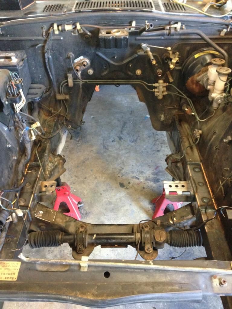

trackzpeed Posted March 29, 2015 Author Share Posted March 29, 2015 Thanks for the encouragement..... I have started tearing down the Z and will have it prepped out complete with a repaint of the engine bay. Bought a 98 ls1 t56 z28 complete that I will campaign for the autoX season until the z bay is ready for parts and swap. Lots of education prior to the swap........ I used up a lot of cash buying the z28 so I'm selling off z parts along the way to fund a swap kit. While I'm selling and saving I'm researching and deciding which kit to ultimately use. I have a crime scene style white board set up to plan my attack. By the way. The steering wheel you sold me looks great. Quote Link to comment Share on other sites More sharing options...
