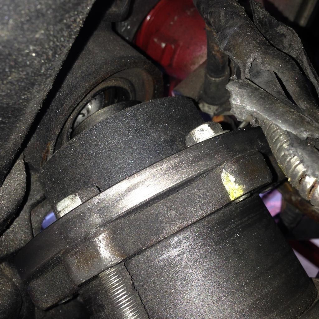

thezguy Posted February 16, 2015 Share Posted February 16, 2015 (edited) So a few of you may know the car from LS1tech. It's the twin turbo 370ci LS 6spd in the FI section. Well this weekend I went to make a Few more shake down passes and ended up snapping the driver side outer stub shaft. This was on a 3k launch (heated NT05r tires) currently the car has the short nose R200 VLSD along with the MM axle upgrades. I'm not sure what stub axles I have as I haven't pulled them yet, pretty sure they are the stock 27spline units. I have a car on my lift at the moment. Well long story short I don't really want to deal with this crap ever again. Habe any of you guys tried the upgraded outer 39 spline stub axles? Anyone broken one? I know there are a few guys beating up the 8.8IRS and we all know a SRA can take the abuse. I'm curious to hear from any other guys who have more than a handful of passes on the 8.8 or other IRS setups. I really don't want to go SRA as A. I don't want to alter factory suspension location (street class rules) B. Going SRA will require a lot of downtime and sheet metal work which I don't want to do. If anyone here is making 800+ on IRS please chime in. I realize this isn't the drivetrain section but I figured the guys who have to worry about stuff like this are lingering in the V8 section anyhow Edited February 16, 2015 by thezguy Quote Link to comment Share on other sites More sharing options...

Daz Posted February 16, 2015 Share Posted February 16, 2015 I'm not sure but it doesn't seem common, most snap the inner. Quote Link to comment Share on other sites More sharing options...

SUNNY Z Posted February 16, 2015 Share Posted February 16, 2015 (edited) From the video, it sounds like it (they?) were already broken. Possibly from the previous launch? Either way, they're toast. Somewhat surprised you got it to hook enough on those 18"? rims to do that. 8.8 Here, with porsche 930 CV's, 31 spline inners, 29 spline outers (240sx) and Its holding up great. Don't know the power the car is making, but it traps 150+, and cut a 1.400 60'. Edited February 16, 2015 by SUNNY Z Quote Link to comment Share on other sites More sharing options...
thezguy Posted February 16, 2015 Author Share Posted February 16, 2015 From the video, it sounds like it (they?) were already broken. Possibly from the previous launch? Either way, they're toast. Somewhat surprised you got it to hook enough on those 18"? rims to do that. 8.8 Here, with porsche 930 CV's, 31 spline inners, 29 spline outers (240sx) and Its holding up great. Don't know the power the car is making, but it traps 150+, and cut a 1.400 60'. The car is on 17X11" rims. Those NT05r tires are sticky as hell.. Plus royal purple raceway is one of the best tracks in the country. Minimal wheel hop on the burnout but it's possible they had some fractures from the previous passes (3) Im thinking about buying the checkered flag 39spline stub axles and trying my luck. I was reading through some old threads and saw you bought them back in the day. How did those work for you and when you ended up going 8.8 why didn't you keep them seeing as they are quite a bit larger than any other option out there. Quote Link to comment Share on other sites More sharing options...
thezguy Posted February 16, 2015 Author Share Posted February 16, 2015 It was only the driver side that snapped. Quote Link to comment Share on other sites More sharing options...

Zfan1 Posted February 16, 2015 Share Posted February 16, 2015 Stock outter stub axles are worthless. I used to snap them left and right when only making 550rwhp running high 9's. I am using the Modern Motorsport ones, sucks that Ross is gone! Quote Link to comment Share on other sites More sharing options...
thezguy Posted February 16, 2015 Author Share Posted February 16, 2015 Stock outter stub axles are worthless. I used to snap them left and right when only making 550rwhp running high 9's. I am using the Modern Motorsport ones, sucks that Ross is gone! Agreed. However joe@checkered flag makes some. They are pricey though.. Are you still on the MM rear end? Quote Link to comment Share on other sites More sharing options...

RebekahsZ Posted February 16, 2015 Share Posted February 16, 2015 We had a weather forecast for ice that wound up being rain. Cancelled morning clinic to keep the old ladies from killing themselves on the bridges. So I'm mid-morning texting like a state employee! Might watch some Days of Our Lives here in a minute. Anyway, if you were running stock stubs, then you must still be 4-lug? Me too. The CF stubs are drilled for both 4 and 5 lug. So far nobody has snapped them. Put antiseize on them and be careful-they are easy to cross thread and gall. If you switch to those (I think CF has a 6-bolt companion flange (?)) and you will be looking for the next weak link, which I predict will be the mounting of the front of your diff. But there is always a weak link, even if it is your oil pan coming down off a big wheelie! I'm definitely not against the 8.8 IRS and I think Will and SunnyZ are fabricating gods. Quote Link to comment Share on other sites More sharing options...
JMortensen Posted February 16, 2015 Share Posted February 16, 2015 (edited) There have been a couple people that have snapped the chromoly stubs from MM, and CF has them made by the same people. The limiter is the size of the shaft. regardless of the spline count, the shaft is still a fairly puny 1.25" diameter. Ultimately the 8.8 with bigger stubs from American FWD applications are going to be the best bet, but they require the switch to different brakes, struts, etc. The CF stuff is strong enough for 99% of the people out there anyway, it's the hardcore drag racers that need to worry about it. That's my $.02 anyway. Edited February 16, 2015 by JMortensen Quote Link to comment Share on other sites More sharing options...
