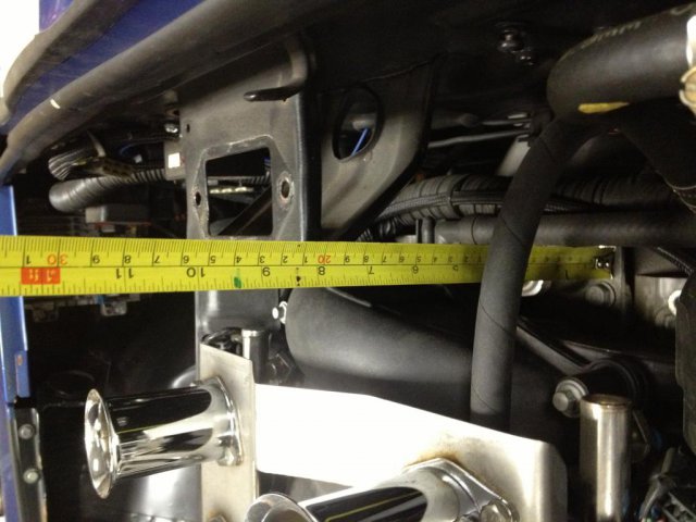

Can you point out the location on the motor that you want me to put the tip of the tape measure? Text me your phone number and I will send some pics to you. I'm at 256-366-4685. Put your name in the text.
I'm from Canada so it may cost you.  Just from the bottom of the intake runner (lowest point on intake) to the bottom of the hood latch.
JCI mounts. Is this the view that you need? I recommend cutting off the hood latch bracket and go to hood pins. The bracket is a pain, the cables break and many racing rule books require pins.
Perfect thanks! I think your right about the hood pins. Seems only the LS1/2/6 intskes will fit under there. I wanted to run the Holley Hi-rise intake but it sits about 2" above the hood. Maybe I will make a shaker hoof like the old 6.6 TA's

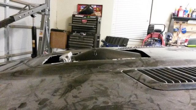

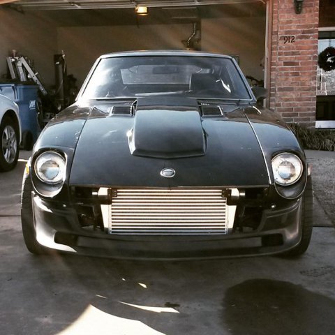

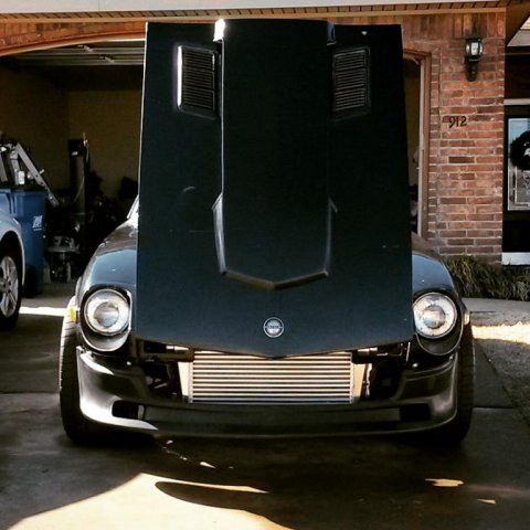

I'm running the Holley Mid Rise intake on my 280z.  It required trimming of the stock hood latch, and while I could certainly use it, I think I'm just going to ditch the latch completely and go with some of those slick flush-mounted hood pins.
And FYI, the Mid Rise does not clear the stock hood on a 280z (I'm using the Dingo mounts).  I tried searching for that before I bought it, but never found an answer.  So there it is.  LOL
Attached are some pics of how much it protrudes from the hood and what I did to remedy it.
