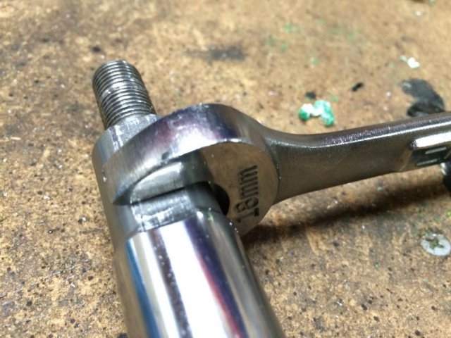

Had an extra rear lying around and was able to machine the stepped surface (directly below the threaded part) to fit an 18mm wrench. In a vise, putting 50 ft/lbs on it with the wrench was no problem.
Can you think of any reason not to go ahead and go this route? It's on a surface of the strut that does not compress into the canister. It's the only way I can see to lock the shaft in place and get measurable torque on the upper nut...
