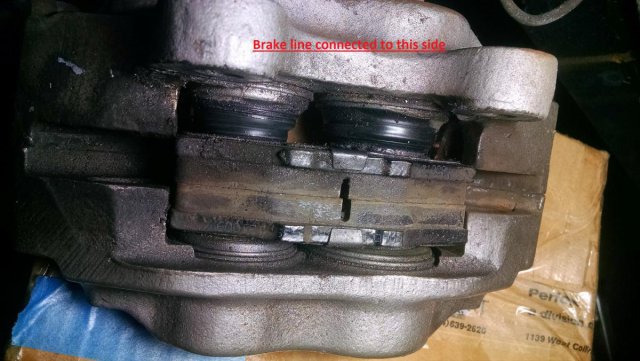

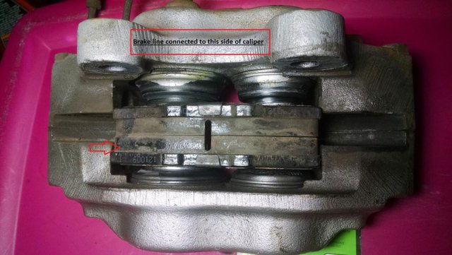

New-to-240z Posted March 5, 2015 Share Posted March 5, 2015 So, I grabed some rebuilt 4x4 calipers SW12 I believe (now I can't remember, go figure). But, I'm getting a lot more clamping force from one side then the other, and the heat generated after a few really hard stops is different on each side (one by a large degree hotter). So, I thought I had a bad caliper that had stuck in its position. I took off the calipers today and pressed down on the brake pedal to see if any specific piston was not pushing out. Here's what I found . . . I thought that both sides' pistons would be pressing out of their cylinder on a fixed caliper? Am I mistaken? You can see that the side that get the fluid first is actually pressing out completely, where as the other side isn't pressing out at all?!?! Is this normal operation? I will be taking measurements of the brake pads soon to see which pistons are pulling back, or aren't pushing out (causing uneven wear). But this totally threw my off?! I did get these from AutoZone, and am guessing that might have something to do with it. But, both calipers? Quote Link to comment Share on other sites More sharing options...
Xnke Posted March 5, 2015 Share Posted March 5, 2015 They're probably fine. Just less work for the fluid to exert the force on one set of pistons that go through the caliper passage to exert force on both sets, given that there is no rotor between them to generate the minute force differential needed to force fluid through said passage. Replace your rubber lines and check for line blockages, would be my bet. Just went through this kind of thing on a 1983 ZX, the rubber lines were internally collapsed on the front brakes, could barely push fluid through them. Quote Link to comment Share on other sites More sharing options...

jasper Posted March 5, 2015 Share Posted March 5, 2015 (edited) The brown coloration on one set of pads is characteristic of OVERHEATING. As a Toyota tech, I replace A LOT of 4 Runner front calipers for stuck/sticking inboard pistons. Always inboard pistons.........don't know why. Roughly 2000 and up vintage. If the pistons go back in easily, I would look for the L/R bias problem. Also check for problems in the Rear, leading to over loading the front brakes. Edited March 5, 2015 by jasper Quote Link to comment Share on other sites More sharing options...

Miles Posted March 5, 2015 Share Posted March 5, 2015 (edited) I have had problems with "rebuilt" calipers new right out of the box. Especially with the Cardone and the cheap Napa house brand calipers. Problems with new out of the box calipers include: Piston would not retract into the bore. Piston seals leaked. Caliper filled with rust and debris that showed up while bleeding. Removing the bleed screw I was able to shake out rust flakes/powder. It happens. If after you have ruled out all other causes take the calipers back and buy Nugeon brand rebuilt calipers at Napa. Other stores may carry Nugeon as well. Unlike the Cardone and other cheap brands, Nugeon calipers are rebuilt in the USA (Stockton, Ca). Edited March 5, 2015 by Miles Quote Link to comment Share on other sites More sharing options...
