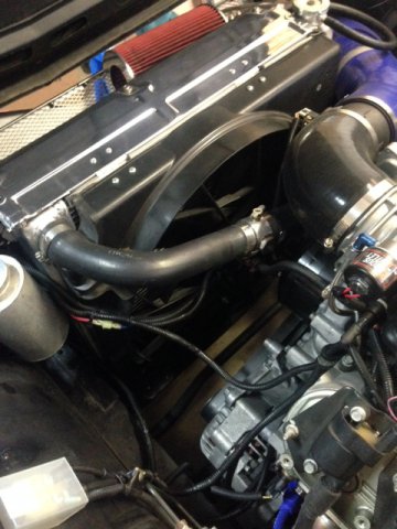

Zfan1 Posted March 14, 2015 Share Posted March 14, 2015 Sorry this is the best I could do with everything in the way 24x19 Griffin radiator with Lincoln 2 speed fan Quote Link to comment Share on other sites More sharing options...
milesz Posted March 14, 2015 Author Share Posted March 14, 2015 Sorry this is the best I could do with everything in the way 24x19 Griffin radiator with Lincoln 2 speed fan Thanks for the pictures. Where did you get that fan shroud? Its looks very nice. Quote Link to comment Share on other sites More sharing options...
Zfan1 Posted March 15, 2015 Share Posted March 15, 2015 It's a one piece unit, 2 speed fan and shroud made by Ford/Mercury for a late model Lincoln/T-Bird Quote Link to comment Share on other sites More sharing options...
milesz Posted March 19, 2015 Author Share Posted March 19, 2015 It's a one piece unit, 2 speed fan and shroud made by Ford/Mercury for a late model Lincoln/T-Bird What lower radiator hose did you use or did you get the radiator with the straight lower pipe. Quote Link to comment Share on other sites More sharing options...
Zfan1 Posted March 20, 2015 Share Posted March 20, 2015 I cobbled mine with two pieces of hose and a piece of aluminum tubing/pipe Quote Link to comment Share on other sites More sharing options...
