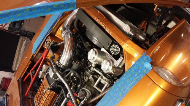

rags Posted July 4, 2015 Author Share Posted July 4, 2015 (edited) I hate when people don't keep their threads updated so here is what I decided on Edited July 4, 2015 by rags Quote Link to comment Share on other sites More sharing options...

We Bad Posted July 5, 2015 Share Posted July 5, 2015 rags, how much boost are you planning on? Quote Link to comment Share on other sites More sharing options...
rags Posted July 5, 2015 Author Share Posted July 5, 2015 Thanks guys! The tuner will tell me how much boost I can run before heat soak becomes an issue. I'm still running the stock intercooler although I did go overkill on the heat exchanger. 8 lbs to start. Quote Link to comment Share on other sites More sharing options...
