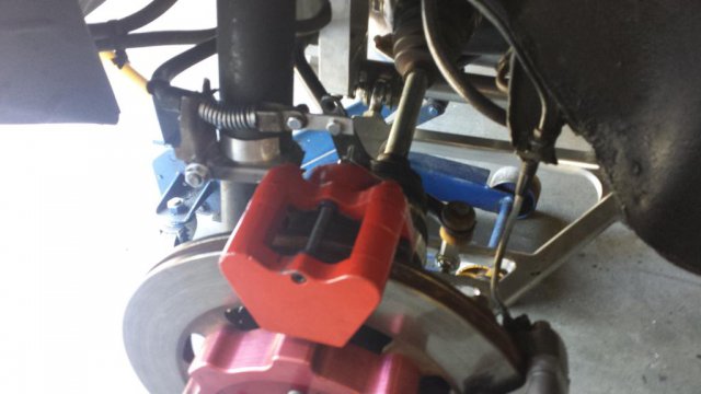

  16. I like what you did. and like you stated, I got a later set with multiple start threads, so I didn't need as long of throw. And since I still had the original cables in place it was easier to use them. I did move the attachment point on the caliper arm closer to the caliper to shorten the required movement of the cable. It holds in my driveway which is quite steep, so I'm happy.
  17. it is right there in the picture.....The chrome wound up thingy in front of the strut housing.

  19. Update, Picture added. I also drilled the supplied bolts for safety wire. Don't trust lock-tite alone.

  21. The good news- I have a parking brake! And I took pictures....but, can't post them because I took them with my camera instead of my phone, and Vicki took my one camera to computer cord with her to France. And I don't want to take the wheels back off right now. If I get a chance, I will take them off and take some phone pictures. I will tell you what I did. I removed the old brake cable mounts from the lower suspension. I bought 2 2" muffler clamps at $2.99 ea. and 2 compression springs at $3.98 for a package of 2. I welded the old mounts to the clamps at one end, lopped off the part where it used to bolt on to the suspension. and mounted the clamps to the strut housing so the mounts are just to the rear of the strut housing and with just enough clearance to the outside of the strut for the cable. I put a spring on each end of the existing parking brake cable between the mount and the clevis. I bolted a 1/2"X 1/8" aluminum bar about 2" long firmly to the clevis and used the old clevis pins at the arm of the caliper. I used the bar instead of a cable extension because it won't bend and will push the arm back. I then adjusted the cables from underneath the car above the drive shaft until the were free with the handle down and clamped tight when I pull on the handle. It does use the full travel of the handle but works. For $10 and half a welding rod I'm pretty happy. I will post pic's when I can. Oh and yes, I have Dave's control arms, mustache bar, and sway bar mounts, but without coil overs.
