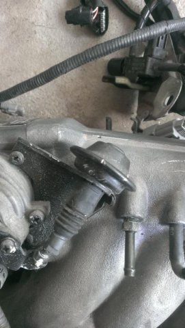

It acts as a stop for the throttle body plate if memory serves, it has a fitting for what I assume is a either a vacuum or pressure source and a ram that that controls the position or stop point of the throttle. I don't use mine, but I'm not very stock anymore. If you are stock and using stock equipment I wouldn't see why you would forgo it other then laziness or simplification.
This no longer retains to the wiring issues as your title states, maybe a generic build thread is in order where you can ask questions such as this.
