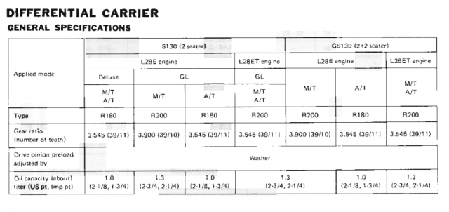

Shanks Posted May 9, 2015 Share Posted May 9, 2015 Hello everyone, Long time reader first time poster. Just double checking with everyone here because I pulled my l28et out of an '83 280zx 2+2 that I found in a junk yard for $800 and was approached by someone who was willing to trade me what was left of the car for a close ratio transmission and rear diff. The car itself was in terrible, terrible shape so I agreed and he showed up later that week with a truck to tow it away. He gave me the parts he promised and towed the really junky 280 for free so I thought it was fair enough. Fast forward two or three weeks, now that the engine is in good shape and ready to go in my 240z, I have just now noticed that the rear diff isn't functioning as it should and the transmission isn't looking any better, I also am just now realizing that the parts he gave me are the same ones that would have come off the 83 280zx anyway..... At least according to this link: http://www.zhome.com/ZCMnL/tech/GearRatios.html So my question for you guys is, is it not true that the ideal ratios I would have been looking for in the first place were already on the 83 280zx 2+2 I purchased and I am a dumb ass for giving them all away for broken parts? Quote Link to comment Share on other sites More sharing options...
NewZed Posted May 9, 2015 Share Posted May 9, 2015 So my question for you guys is, is it not true that the ideal ratios I would have been looking for in the first place were already on the 83 280zx 2+2 I purchased and I am a dumb ass for giving them all away for broken parts? Your first question is really - "are the transmission and diff ratios of a 1983 280ZX 2+2 suitable for an L28ET in whatever car you're planning to install them in?" Maybe. There's more to the calculation. They don't seem to be what the typical turbo ZX had though, if that's what you meant. In other words,what you traded ws not the same as what you received. The transmission in the ZXT was probably the Borg Warner "T5" which takes work to install in a Z. Which is probably what you have. If you gave good parts away,any good parts, for broken parts, that's dumb. Are you sure they're broken? Quote Link to comment Share on other sites More sharing options...

Shanks Posted May 10, 2015 Author Share Posted May 10, 2015 If the equipment is indeed in usable condition than I feel better about it. I will have to make sure about that later though. And you are right about the T5 there is more fabrication that is needed. For now, I am second guessing the gears for my engine set up, so lets forget about the guy and focus on transmissions and diffs. I see lots of people who are doing l28et swaps into the 240z go with a 77-79 3.321 (first gear) transmission and pair it with a r200 3.9 for the quickest acceleration, but I have read that with anything larger than a stock turbo the gears are so quick that it is better to go with a taller gear ratio to give your turbo time to catch up. My question is, is the 81-83 NA transmission with the 3.062 first gear going to be overkill? Or should I keep the 77-79 transmission and go with a R200 3.545? Links to other set ups that I haven't found would be great I just haven't had any luck finding them. Quote Link to comment Share on other sites More sharing options...
