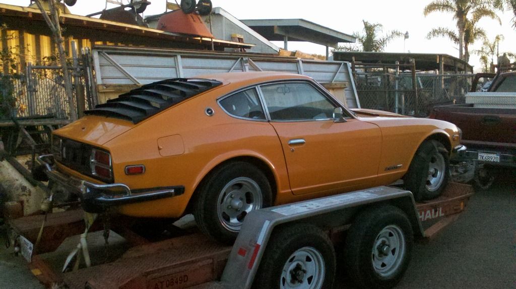

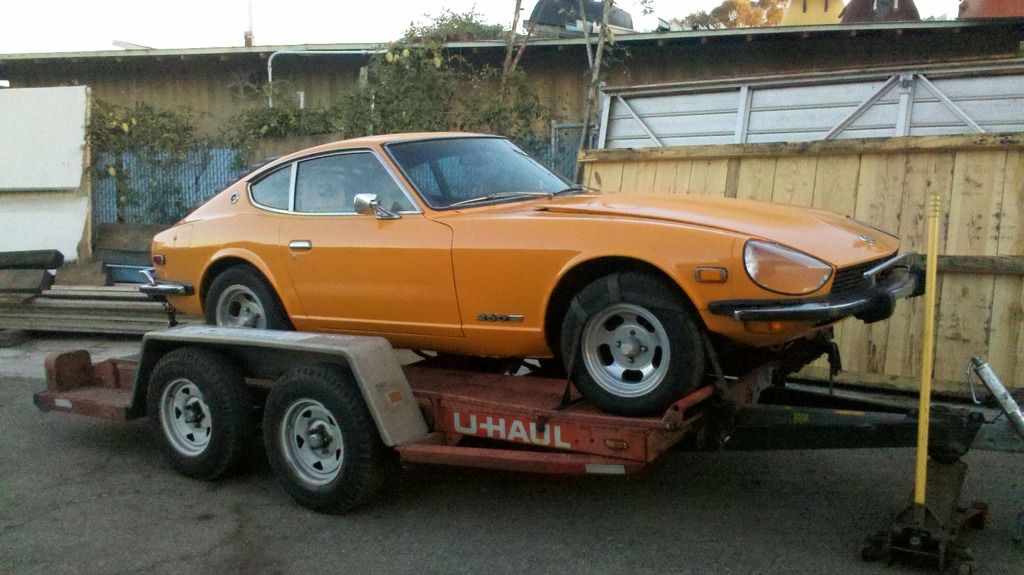

Purchased a 1974 260z in November of 2013.

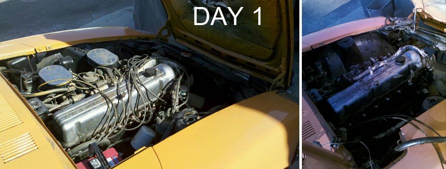

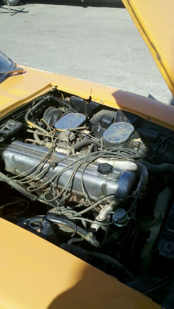

Pulled the motor

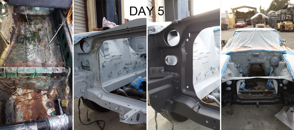

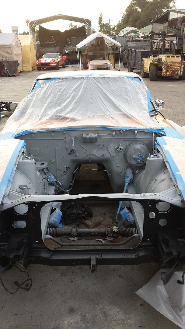

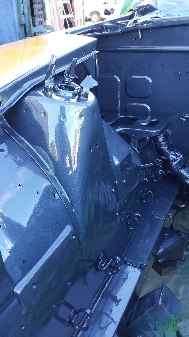

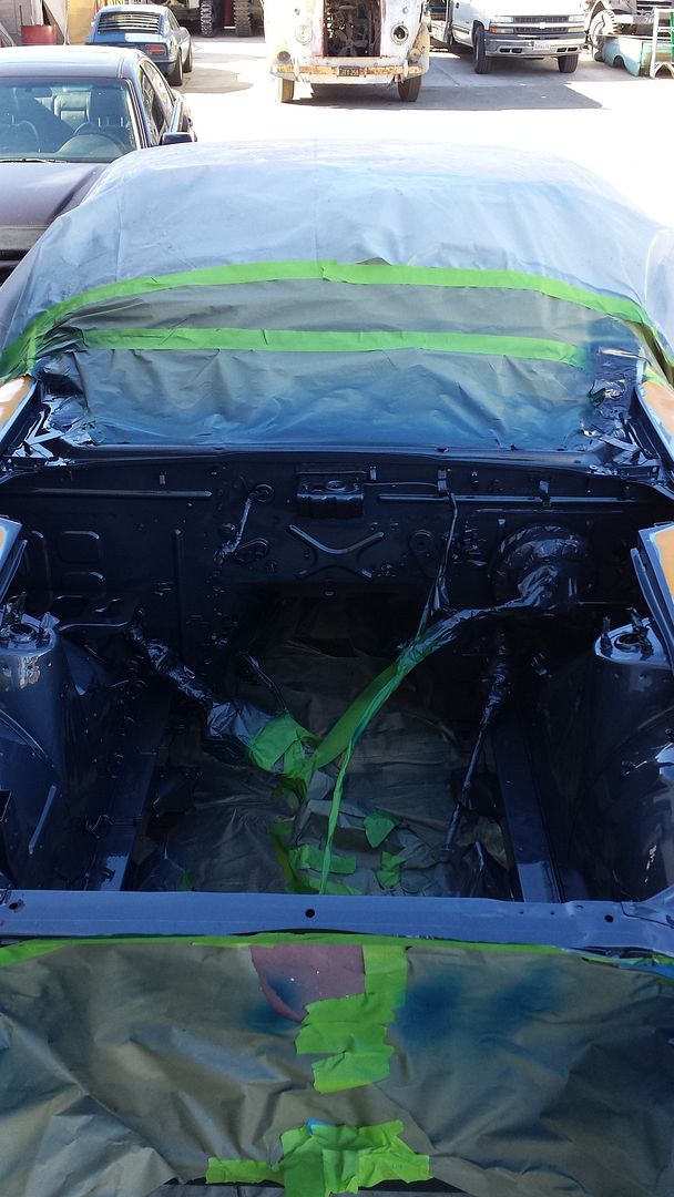

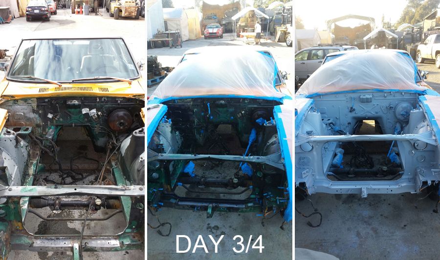

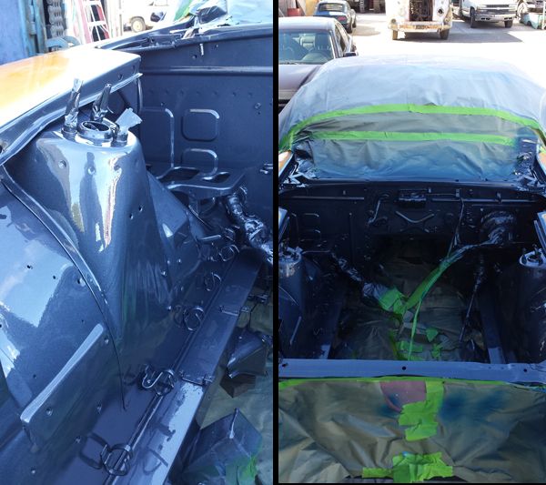

Cleaned out, sanded, steam pressure washed and primed the engine bay
Primed for paint, painted the front grill flat black
Shoreline blue pearl

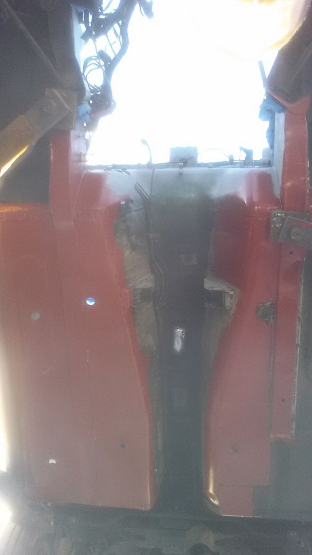

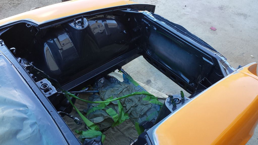

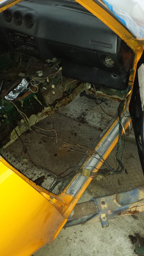

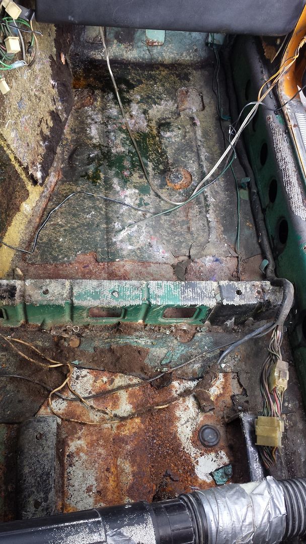

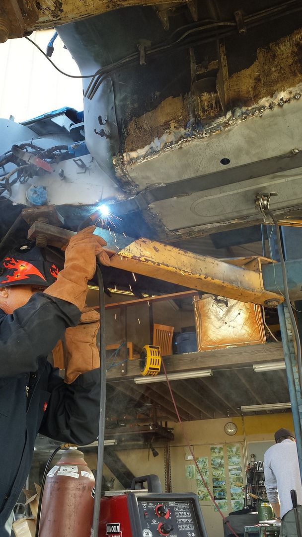

Needed to replace passenger side floor
Painted on rust inhibiter, also sprayed everything with ruberized undercoating

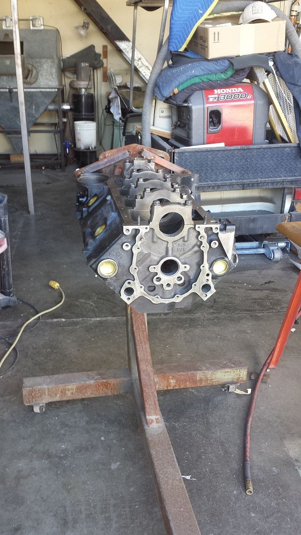

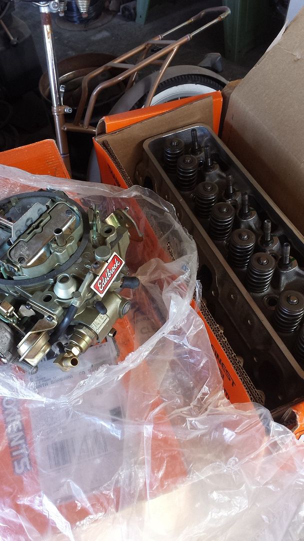

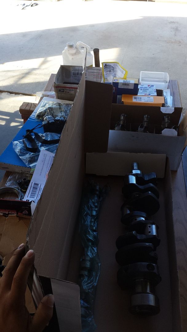

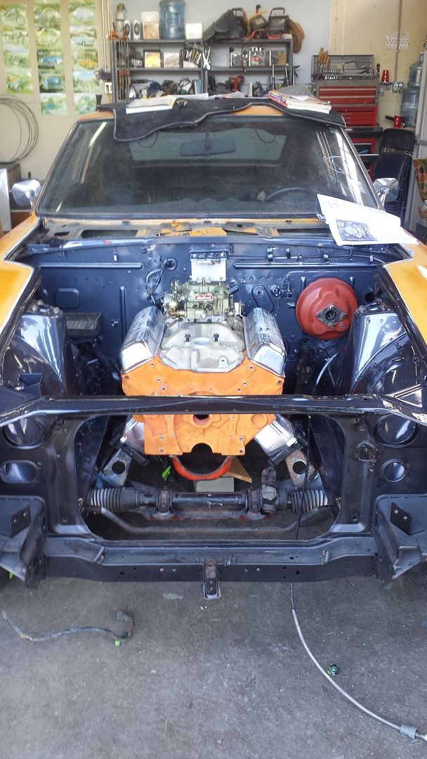

Building the engine
engine mock up

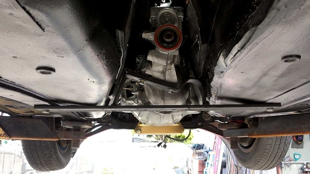

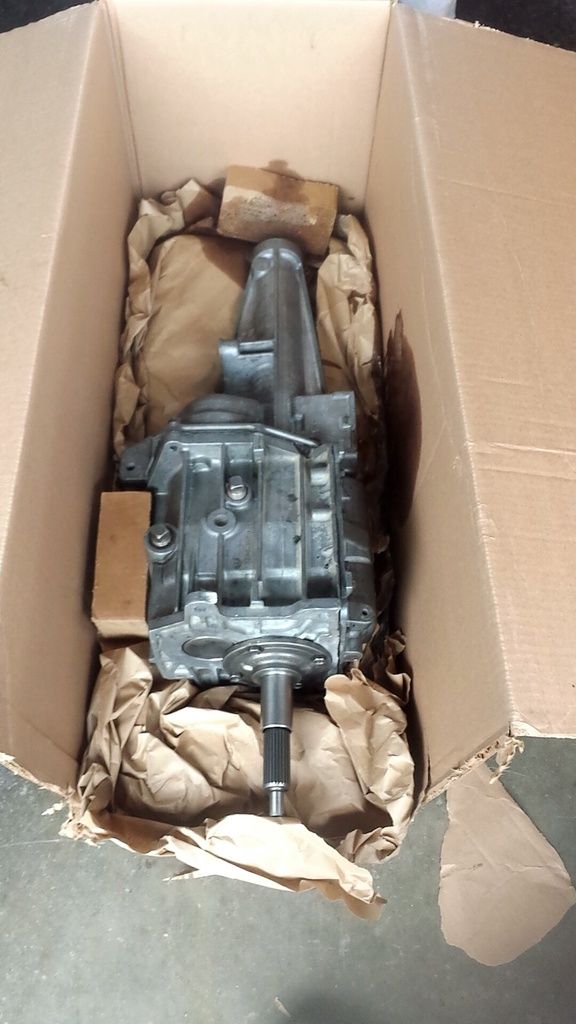

T5 transmission

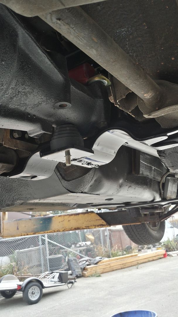

Made this transmission mount and allowed room for the exhaust to sit higher in the tunnel (in between the mount).

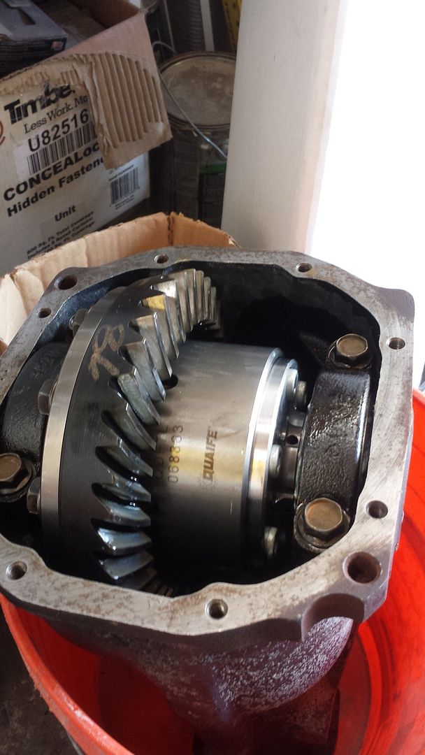

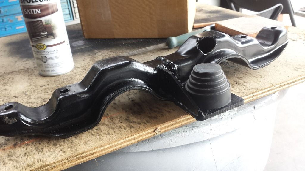

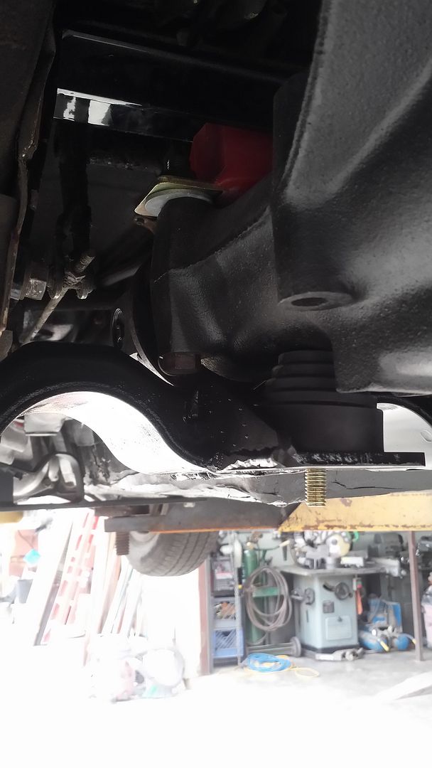

Bought an R200 diff and put a Quaife LSD
Made a custom front differential mount to accept dual exhaust. Basically ordered another front mount, cut both and welded them together with an extened landing. Cut a hole out for bolt clearance on the differential.

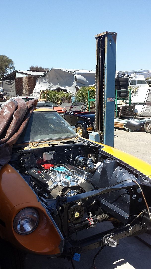

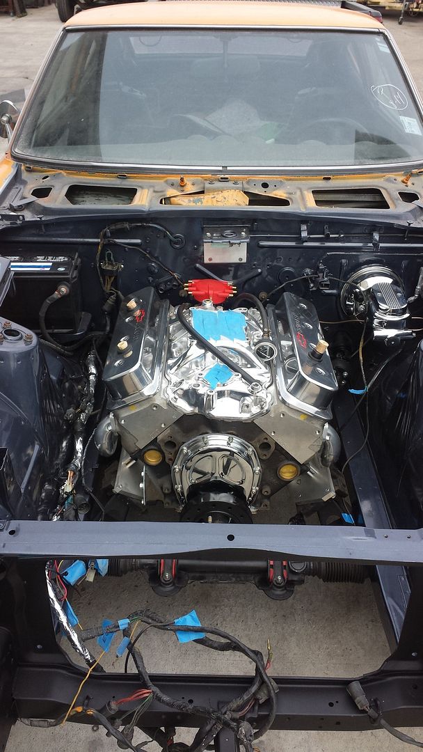

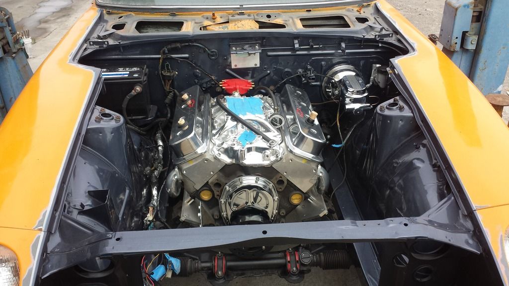

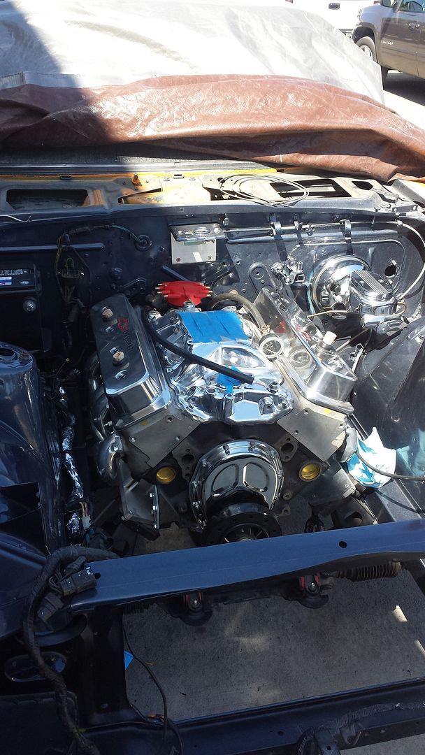

Motor installed with brake booster, battery, master cylinder, heat wrapped wire harness by headers. Polished intake manifold, master cylinder, timing cover and valve covers
Not pictured yet, but also have the driveline installed and 300zx turbo axles and radiator being cleaned up now
One of the pictures at the bottom of the page shows and after market brake booster and master cylinder.
Can you provide details e.g., p/n, how was it installed and the cylinder diameter?
What brake set up are you using with the booster and master cylinder?
Brake booster was from Summit Racing, part #RSD - J700156
1 in bore, 7 in diameter
Master cylinder also from Summit, part #WIL - 260 - 1304
Outlet size 3/8-24 in, bore size 3/4 in, master cylinder stroke 1.4 in
Have not made a final decision on brakes
You may want to exchange that 3/4 clutch MC for a 7/8 MC.  The 3/4 MC has been shown to not have enough throw when used with a T5 transmission.  I have used the 7/8 MC on two builds with T5 transmissions. Works good.  Also, I discovered that the clutch pedal bump stop (sheet metal bracket) on the floor of my 240Z was preventing full clutch release so I removed the bracket.
Currently using: Summit Racing Part Number: WIL-260-10374
