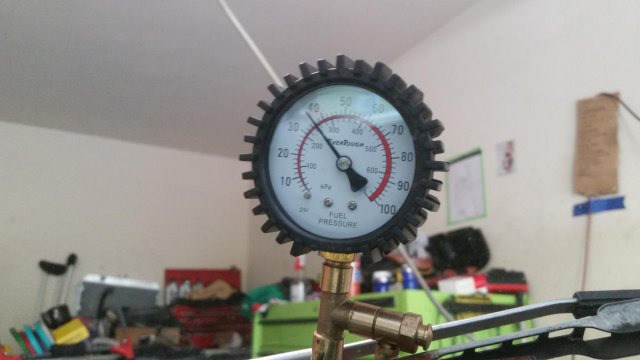

malibud Posted September 23, 2015 Share Posted September 23, 2015 since you dont have a wideband I would check plugs, . get a fuel pressure tester either in line or harbor freight not expensive. are you using a rising rate regulator?. Can't remember but I assume you have checked compression ... Quote Link to comment Share on other sites More sharing options...
hwvigo Posted September 23, 2015 Author Share Posted September 23, 2015 I have a in line fuel pressure gauge on order should be here this weekend I hope, I am still on the stock regulator, and compression is good but could not hurt to check one more time. just because Datsun, and I am ordering a WbO2 today Quote Link to comment Share on other sites More sharing options...

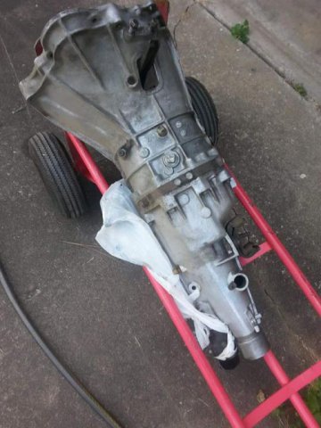

hwvigo Posted September 24, 2015 Author Share Posted September 24, 2015 Ok I think I have found the causes.. 1. The waste-gate is messed, disconnected it and the car runs better. 2. The BOV is leaking when the the line from the intake is hooked up so I need a quality BOV. 3. Even with the waste-gate disconnected the car will not boost more then 8 psi I believe the turbo needs some love. Now on the plus side. 1. Fuel pressure is good but a touch high I believe 37@ idle and will just up to almost 50 while under load. 2. Car is a blast to drive even with with only 8 psi and a auto trans and compressor back feed when I let off the petal it sounds like a HKS ssq 3. I am going to get a the turbo upgraded to a T3T4 by AZ Turbo, and a new Turbosmart internal 10psi wastegate, and a new exhaust and new BOV. 4. I picked up a 5 speed Got the GoPro charging and I am going to shoot some vid later to show how the car is running now. Quote Link to comment Share on other sites More sharing options...
