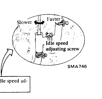

NewZed Posted September 23, 2015 Share Posted September 23, 2015 Get one of these from a 280ZX. Or just put a 280Z throttle body back on. Most people say if you haven't done any cylinder head work the 240SX TB is too big anyway. Quote Link to comment Share on other sites More sharing options...
