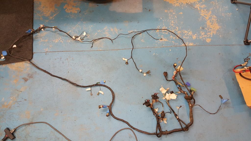

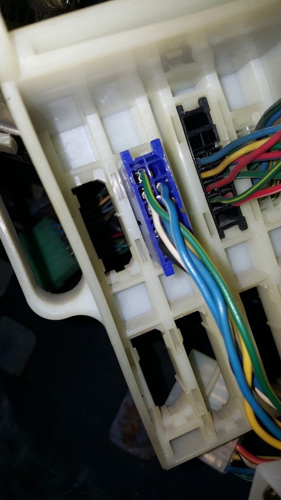

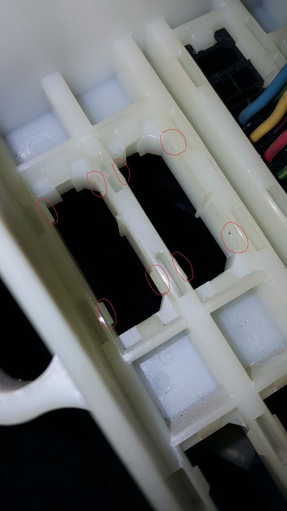

Stock Car Mafia Posted January 24, 2016 Author Share Posted January 24, 2016 So I've been staring at this god awful Datsun "engine room harness" for many weeks now. I can't stand how shitty the fusable links and most of the harness looks so I finally pulled it. I stared at the junction box for a good 5 minutes. I didn't want to cut the wires just to get it out or chop up the box either. The plug has two front facing clips that lock it in place, but on the back there are 4 clips that don't seem to be flexible enough to get the plug out. My option was to take a razor blade and cut those 4 tabs off. I circled the tabs I'm talking about in the picture below. I have yet to determine how to rework this harness. Initial plans are to delete the transistor ignition unit and all associated wiring for the old motor. The charging/ignition wiring will be run through the same location and I might run the lights/blinkers through the wheeel well so the engine bay isn't so cluttered with wiring. I'm open for ideas! Quote Link to comment Share on other sites More sharing options...

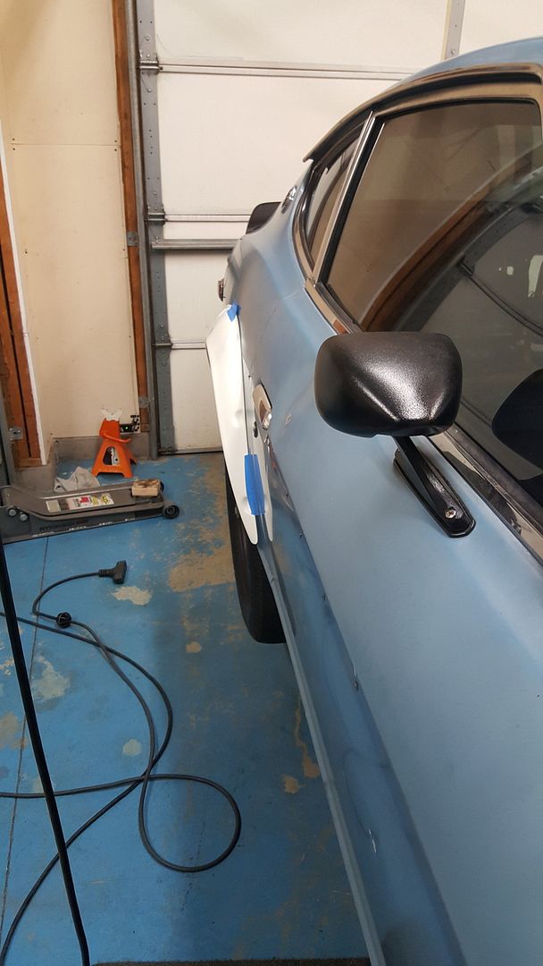

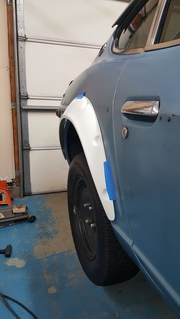

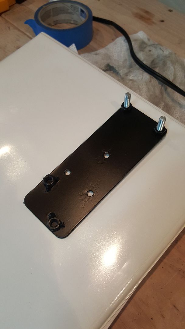

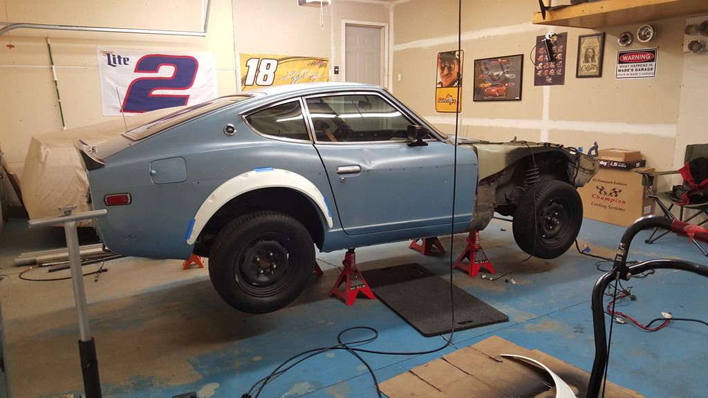

Stock Car Mafia Posted February 3, 2016 Author Share Posted February 3, 2016 (edited) Still dealing with residual back pain but I have meandered out in to the garage for a bit here and there. I was able to get the LS2 gas pedal adapter plate spray painted. This is the first time I have used the VHT roll bay and chassis paint but I really like the look of the satin black. The fender flares also did arrive. They are great about communicating any updates and they also shipped quite fast. Here is just a test fit for the rear flares. They fit EXTREMELY WELL and are way better quality than the ones from The Z store. I really can't wait to tackle the suspension and make this happen I've been spending way too much time still thinking about how to route the wiring. I tend to over think things but hell I only wanna do it once! The computer and fuse block are fulling mounted. The wire loom for the fuse block was quite long so I spiralled it up and pushed it high enough and out of the way. I chose to run the majority of the loose wiring along the wire holders for the antennae stereo wire. The following wires will run the width of the car to the passenger side: - Engine harness 12 V power wire - Fan 1 ground feed - Fan 2 ground feed These items will split from this routing and run up the steering column: - Tach signal - Speedo signal - Engine harness switched power wire I don't have the wires in front of me right now but the ODB2 port will need to be mounted as well. I will have to see the best hidden spot to put this when the dash is back in. Edited February 3, 2016 by Stock Car Mafia Quote Link to comment Share on other sites More sharing options...
RebekahsZ Posted February 6, 2016 Share Posted February 6, 2016 I put my OBD port between the passengers knees just sheet metal screwed to the bottom of the dash. You will need access to this port during tuning and trouble shooting and you will need somewhere to lay down your laptop. Your pedal bracket is beautiful! WAIT to do your flares till you have car on the ground at ride height with your ultimate suspension and the wheels/tired you plan to run. Leave room for suspension travel. Many guys mount them too low because they have the wheels off the ground when they mark. Quote Link to comment Share on other sites More sharing options...
Stock Car Mafia Posted February 6, 2016 Author Share Posted February 6, 2016 (edited) For now the ODBII reader I have is bluetooth so it really can be put anywhere. I would like it on the passenger side as you said though, as in my Mustang, the cord is usually strung across me to the computer in the passenger seat. Thanks for the kind words on the bracket! I guess this is my redneck way of getting the job done, but I am pleased with how it turned out. I do believe Hoke is coming out with more LS2 swap parts for these cars and his work is TOP NOTCH! I wish I could have waited for this swap kit. I am for SURE waiting on the flares. I just wanted to get them in so I don't have to wait for them to ship when I get to that point. I for sure need to get my coilovers welded in, tires mounted, and then put on the car. I would never do flares with it up in the air! I want to see how the car sits with full weight first. And still it may need to be drove a bit for the suspension to settle. But the beautiful thing is the adjustability you get with the coilovers, so it can always be fine tuned. Edited February 6, 2016 by Stock Car Mafia Quote Link to comment Share on other sites More sharing options...

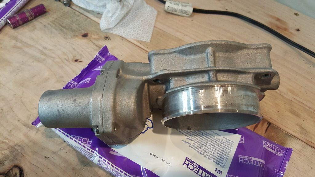

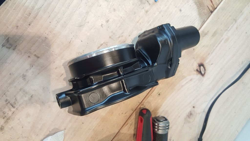

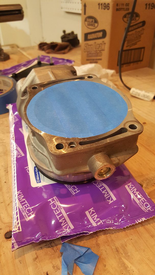

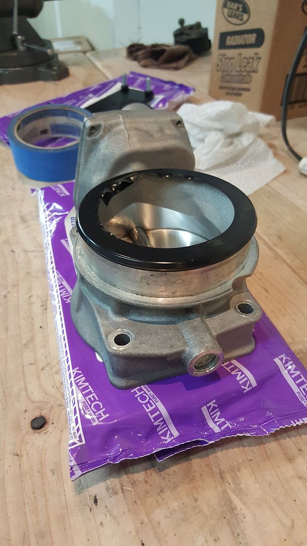

Stock Car Mafia Posted February 12, 2016 Author Share Posted February 12, 2016 I decided to paint the throttle body satin black. The aluminum was looking a little worse for wear and I believe it will flow better closely matching the intake and then the 90 deg. elbow for the intake. I used electrical tape to mask off the inlet as it was easier to mold and get a nice clean line on it. I taked over the outlet and gently used a knife to cut out a rough circle. The throttle body electrical plug was just taped off as close to the base as possible. I am pleased with the look and I don't think I will have to touch this up very often. Quote Link to comment Share on other sites More sharing options...

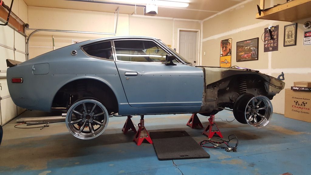

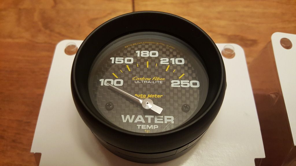

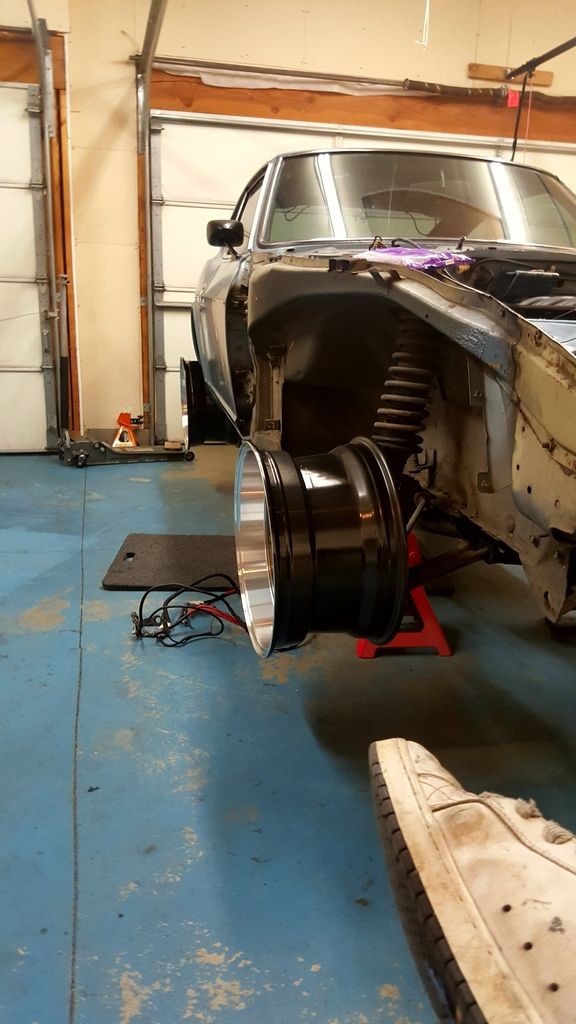

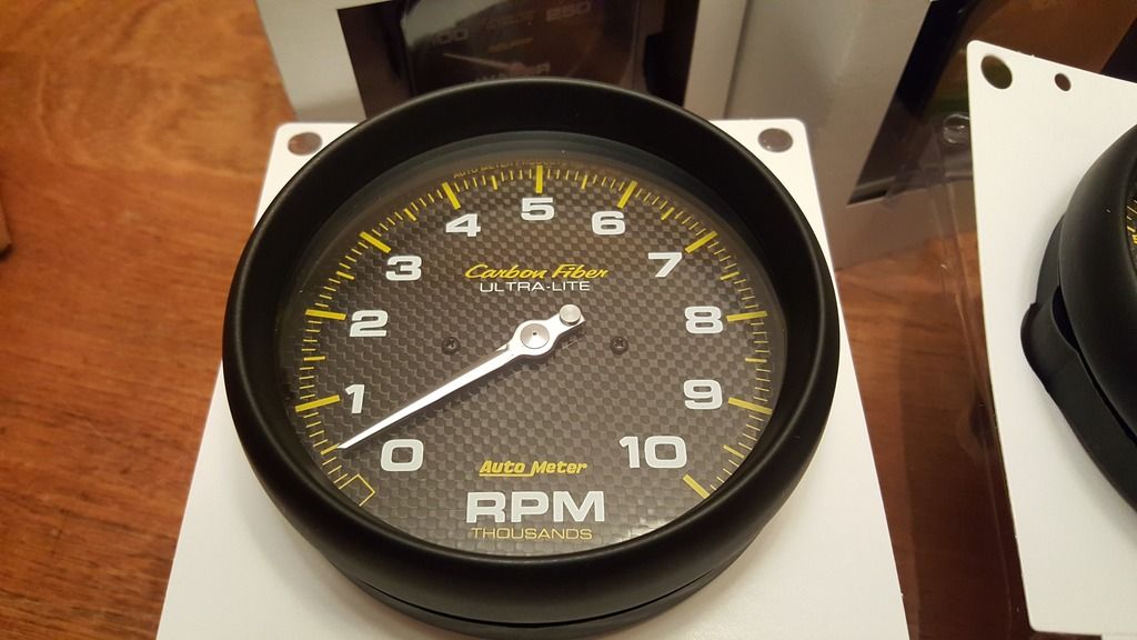

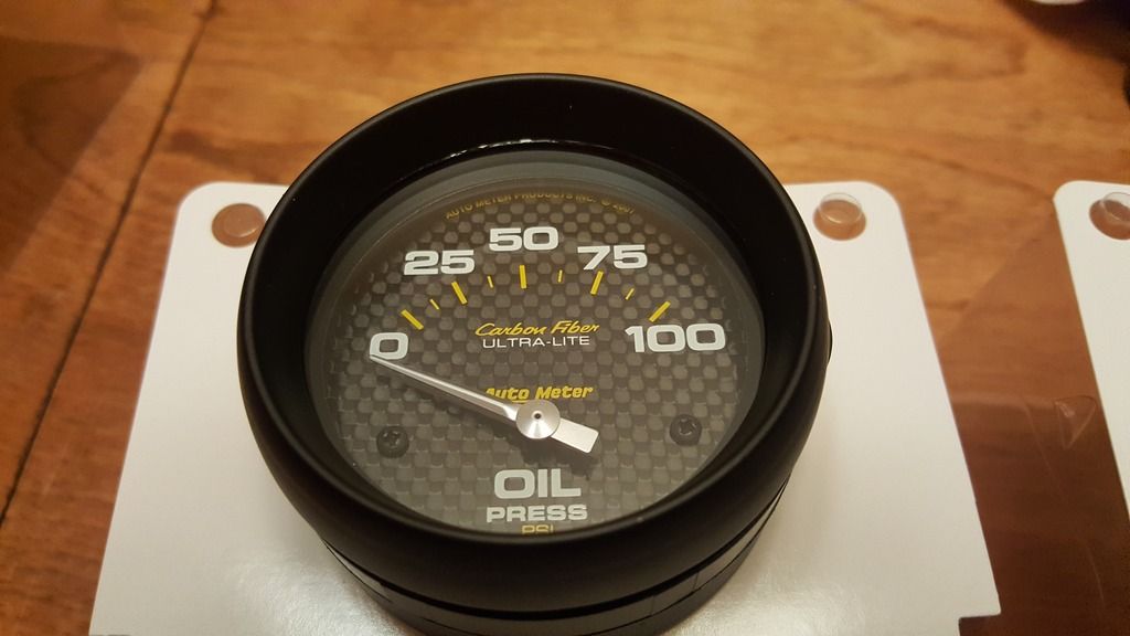

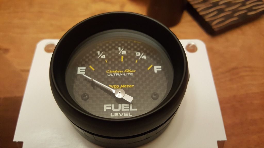

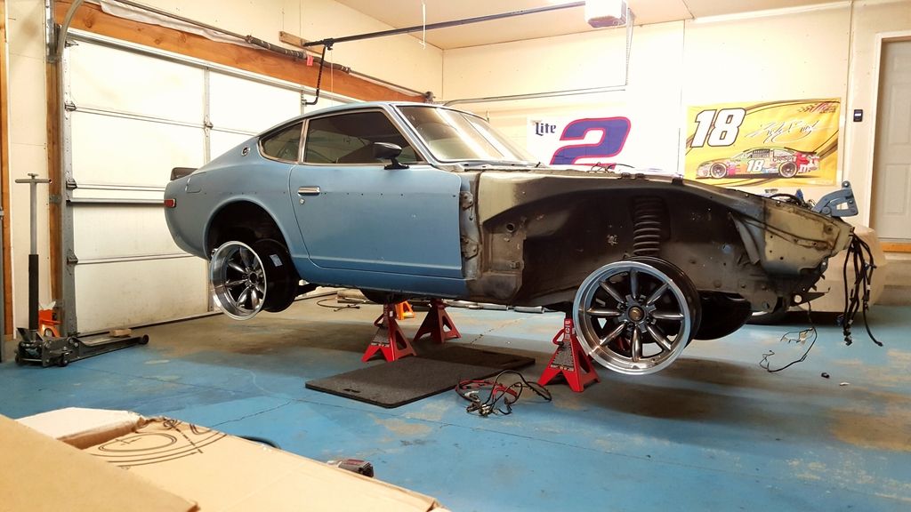

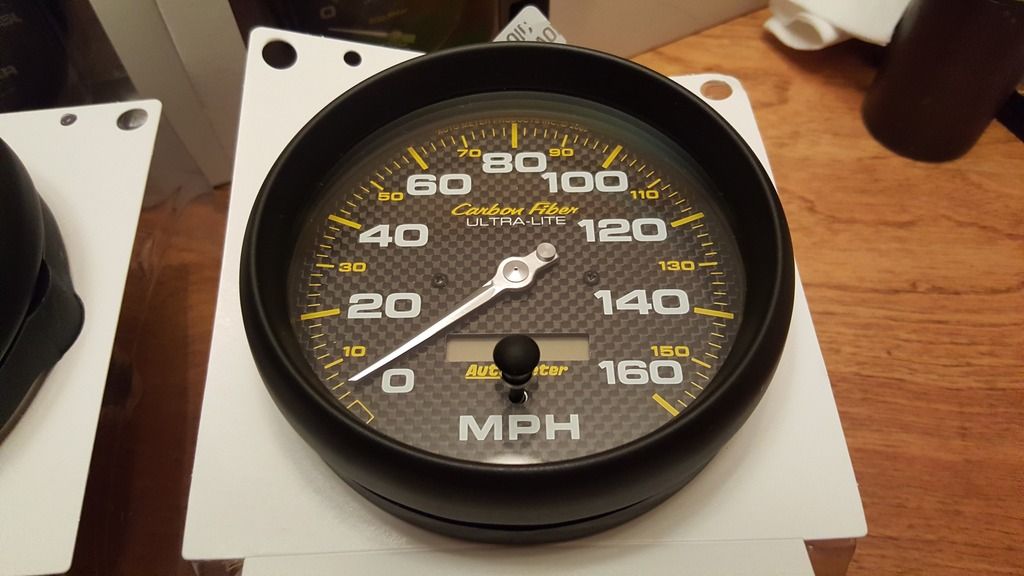

Stock Car Mafia Posted February 12, 2016 Author Share Posted February 12, 2016 The wheels are finally here and the gauges came while I was away this week! Quote Link to comment Share on other sites More sharing options...
