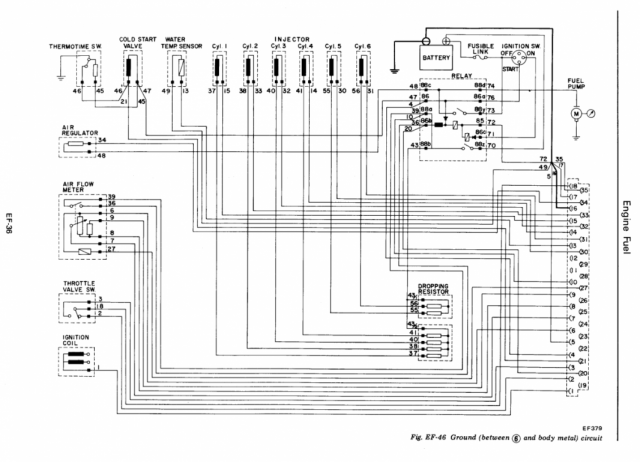

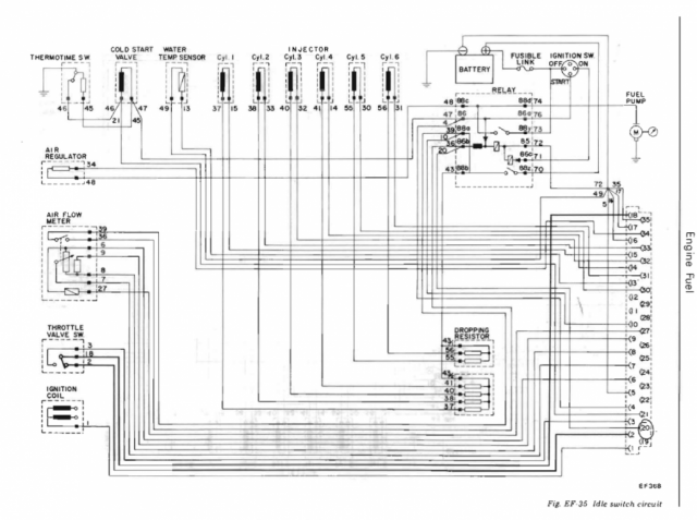

NewZed Posted November 11, 2015 Share Posted November 11, 2015 Compare the wiring diagrams in the Engine Fuel chapters of each year FSM. If you don't feel comfortable figuring out where the power's coming from you might want to rethink it. But it looks like they didn't change the relays until 1978. Your information in Post #1 about the relays doesn't seem to be right. So 1975-76 should be a match for your car. You might even end up with spare parts. Get other parts like the ignition module and distributor if they seem in good shape. Thermostat housing, water pump, etc. All worth a look. Quote Link to comment Share on other sites More sharing options...
dexter72 Posted November 15, 2015 Share Posted November 15, 2015 Helpful tip: Check all the fuses before during and after the install. When you do the wiring for the efi and ignition relays, go over the diagrams 10 times before you install it in the car. Then go over the diagrams 10 times after you have it set up in the car. Make sure the fuses are good and connections are soldered well. I swapped an 83 efi engine and efi wiring into my 260 and still missed a ground for one relay. Car wouldn't start, No ignition, No ecu power, injectors wouldnt spray fuel. I could run the engine on starting fluid though. I didn't figure it out for 2 weeks. Was going over the wiring with a factory diagram and found the missing ground wire. Added it and engine started right up. Quote Link to comment Share on other sites More sharing options...
