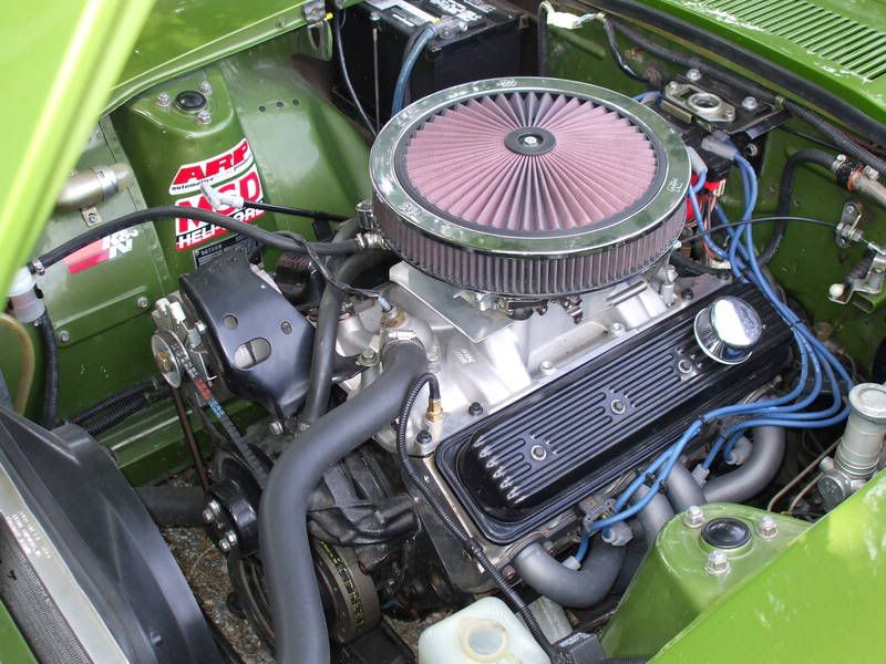

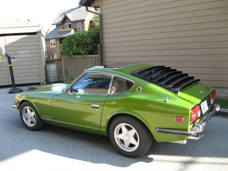

datsfast Posted November 13, 2015 Author Share Posted November 13, 2015 The car I have for the conversion is a really clean '73 240z that is currently fitted with a SBC, T5 gearbox, and a R200 diff. The car goes well enough for me as is, and would probably benefit more from a better suspension and brake set up, but I can't let this engine package slide on by...... I think you've got it covered. How about driveshaft-to get the yoke (even if you just use it to shove in the tranny to keep the oil from running on the floor. Muffler? Exhaust tubing? Section of the bed floor to cover spare tire well? Tranny cooler hoses? All the weatherpack wiring connectors you can cut off. All the wiring you can save (comes in handy). Shifter (if not on column). Service manual. Manuals out of glovebox. Thanks, I'll grab the driveshaft and most likely the exhaust for the nice mandrel bends. The muffler is huge, so I think I'll let that go. I have plans to use a manual gearbox, so cooler lines and shifter can also stay. The weather packs are a good idea, I'll see what I can cut out. I have no plans to modify the spare wheel well, but good suggestion there to use a section of the bed, thanks. The manual from the glovebox is pretty rough, as the truck sat through a Canadian winter with no windows and the book on the passenger seat. If I can save it, I will keep it. If you can, re-title your post to say "LSX swap parts" or something similar. I ignored your post when I first saw it because it looked like another ill-informed person asking a simple question. "Parts gathering" - boring! Okay I understand, but I don't see how I can edit the title, sorry. In hindsight, I would have skipped by that title too . Quote Link to comment Share on other sites More sharing options...
RebekahsZ Posted November 13, 2015 Share Posted November 13, 2015 Dang, that's a nice car already! Sure you want to redo one that's already that nice? Quote Link to comment Share on other sites More sharing options...
trackzpeed Posted November 13, 2015 Share Posted November 13, 2015 +1, that's a nice little Z already. Quote Link to comment Share on other sites More sharing options...
