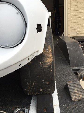

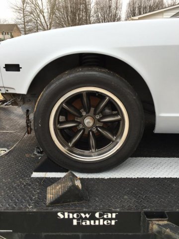

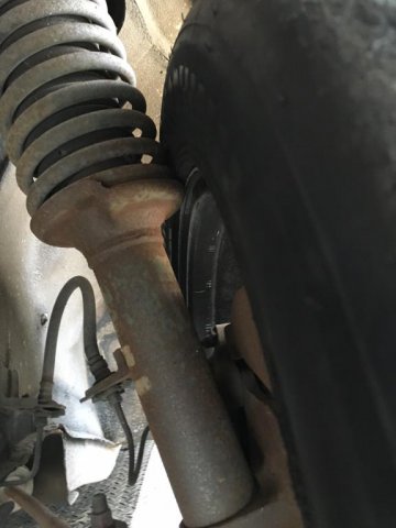

RebekahsZ 106 Posted February 27, 2016 Share Posted February 27, 2016 (edited) I put my 16x8" Rota wheels with 245/45/16 Hoosier R6 tires on my new 75 280z in place of one of the flat tires that were on it. I just grabbed them out of storage to get the car on the trailer when I bought it out of a barn. The car had stock suspension, whereas I run coilovers in my race car. Here's the result. The wheel rubber metal on metal on the lower spring seat on the inside. And hung out the side of the fender on the outside. Since the car was at stock ride height, rubbing would only be a problem on the outside unless the suspension compressed about 3". Edited February 27, 2016 by RebekahsZ Quote Link to post Share on other sites
