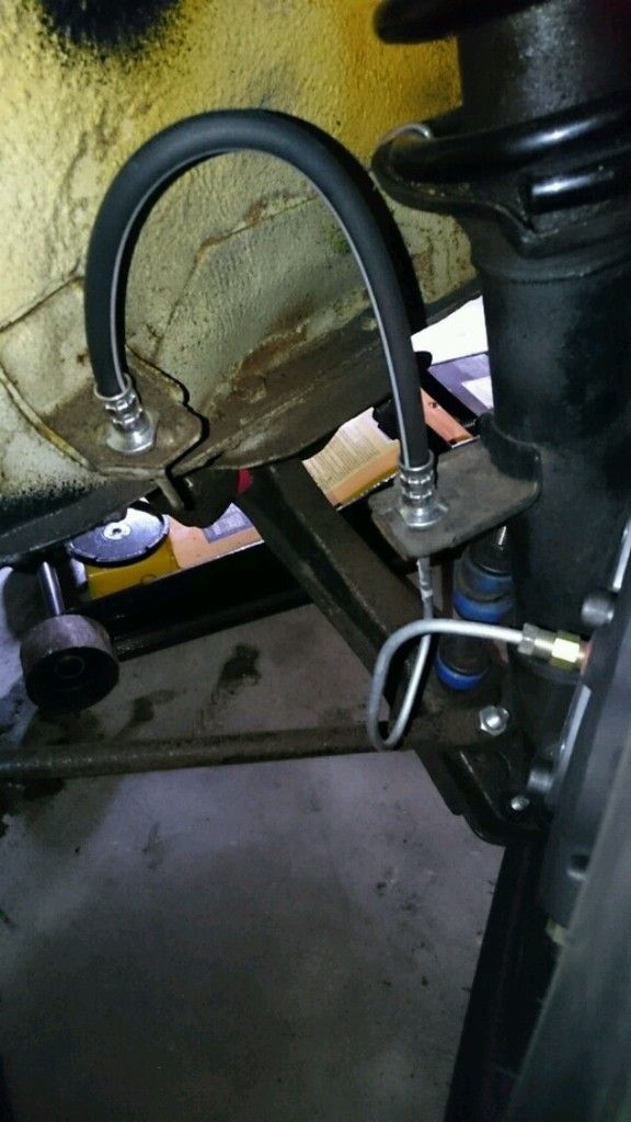

Next I installed the brake kit, and the SS brake lines. The provided lines and fittings did not provide an acceptable routing (see the pics below). I used the alternate hose -> caliper fitting (a 90 degree coupler) but the lines were too short for that configuration and pulled tight when the steering was at full lock, and rubbing on the tire at full opposite lock. Using the straight fitting led to very tight bends in the hose, that worsened as the steering was turned. Eventually I decided to run it using the straight fittings, and would keep an eye on the tight bends to ensure the hose didn't fatigue.

I wound up purchasing a 10mm flare -> NPT fitting to join the stock hard lines to the wilwoods, and some brand new rubber hoses to get a propper routing. I have no idea why TTT would not route the SS line to the strain relief on the strut, and use hard lines like the stock system. It seems to me like a reliable and safe way to route the lines, and would not leave any of the routing up for interpretation. Costs to install brakes: Fittings 25$ CAD + 20$ shipping, Brake Flex Lines 20$+ 30$ Shipping. New total: 2875$.
Overall installation of these components that should have bolted on cost me 195$ extra, and I am stuck with rubber flex lines instead of SS. Some pictures of the issues are below.

My version of brake hose routing:
1/8NPT -> 10mm Flare Fitting: http://www.lowrangeoffroad.com/1-8-npt-male-to-m10-1-0-female-inverted-flare-adapter-fitting-diy-a-1-8npt-m10.html
