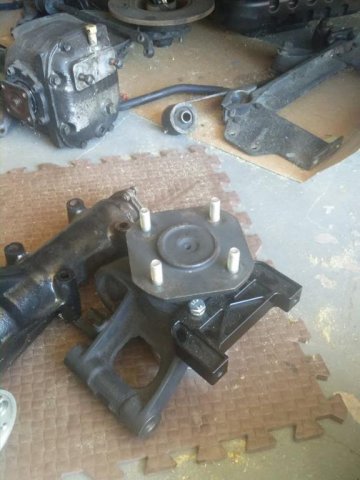

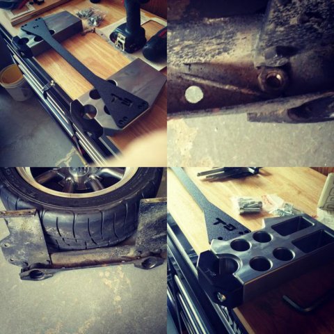

Newbie

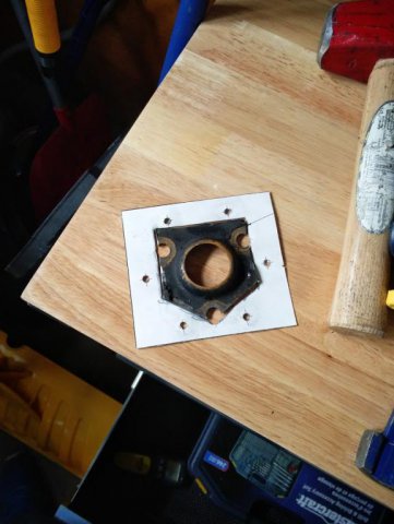

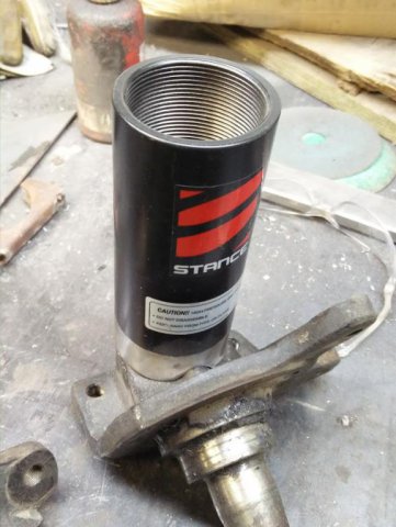

Newbie (1/14)
Reputation

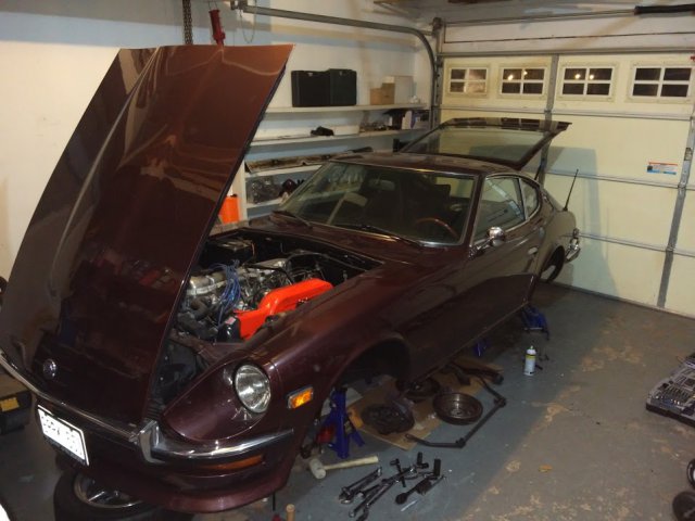

  1. So I know its been a long time but lots of progress was made last summer, and I was back driving the car. T3 control arms front and rear, tension rods, steering coupler, moustache bar, drop mounts, installed along with Wolf Creek Racing CV's, STI stub axel adapters, r180 STI diff, RT diff mount, T# big brake kit front and rear....... April the car goes for body work, repaint and some other goodies. Car was aligned and corner balanced this past fall, and I cannot get over the change in mechanical grip. Suspension and CVs are loud but that comes with the territory. Big spring for the car. I have been bad at updating on here, but feel that I owe it. check me on instagram for updates @theburbankbuild_s30

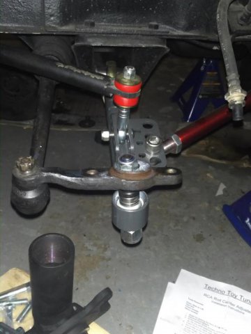

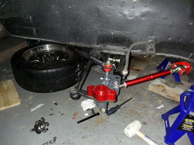

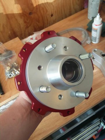

  2. So not much progress being made here. Missed ZCON. first time in CAnada, and in my back yard......missed it. Cool. Started assembling hubs and started dicking around with the front set up. Very concerned with clearance issues with the RCA and the GTx2 control arms. Had a chat with the Josh at T3. Super helpful guy. Lots of info. They have gone to a shorter shouldered nut on the bottom of the post on newest version, as well the post is now 5/8" not 3/4". Leaves me in a bit of a bind on this one though. If I cannot clear might get a shorter shouldered nut and cut the excess post. Will not know till it all goes on. Not so worried with the final wheels they are 15*9 +53- so i doubt the much of anything will be inside the barrel of the wheel. but the 15*7-0 will be a different story. I have not cut the car to put flares on yet, as I was hopping to run the 15*7 -0 till I was ready to go wide.

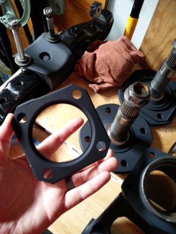

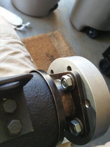

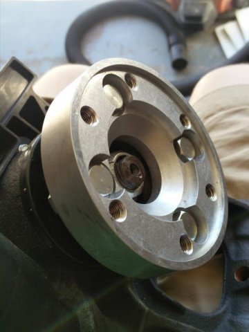

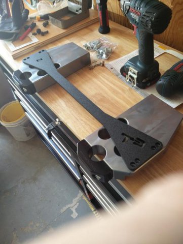

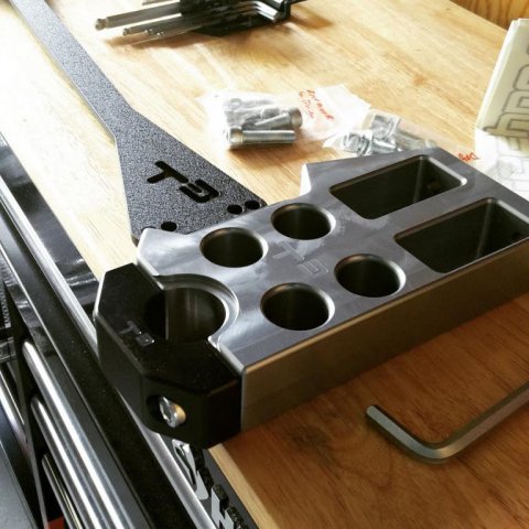

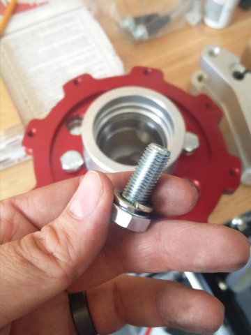

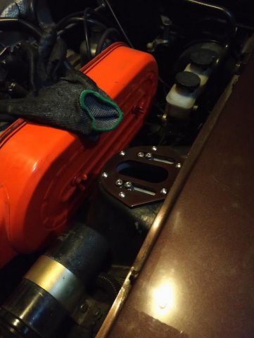

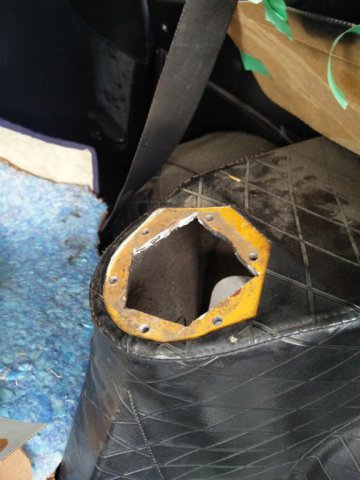

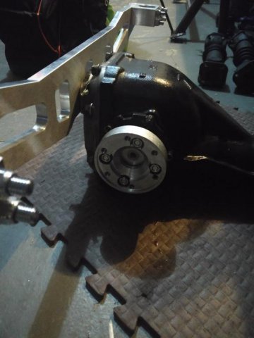

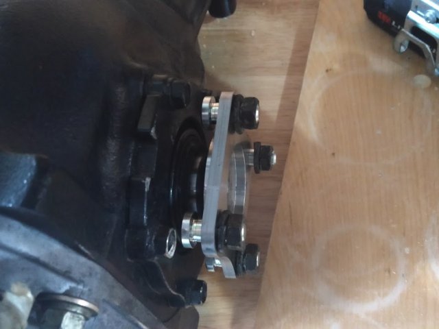

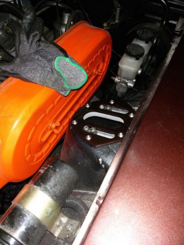

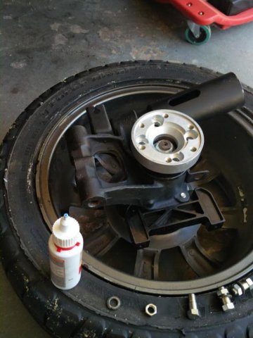

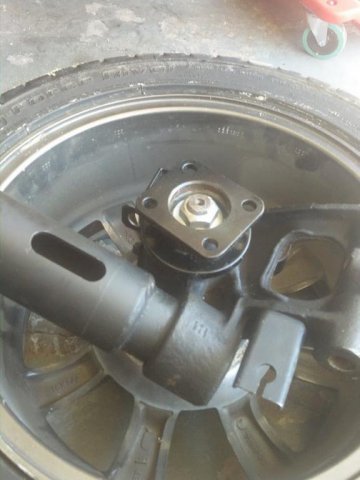

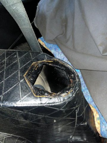

  5. Ok- so I am staying true to my promise to myself that I would keep documenting this as I progress. So installed the CV adapters for the wolfcreek racing CV kit. Borrowed some Blue Lock tight from work and buttoned these up. New hardware and it matches nicely with the t3 m mustache bar. Finished cutting the strut towers and lining up the Sakura Garage camber plates. It is a bit of a pain cutting them with the hatch still on ( realitive to cutting the front towers) Forgot to get a picture of it all finished and painted but will put up another shot. Installed the CV adaptors to the companion flange on the out side assembly. Found this was really easy to do by fliping a wheel on its face and mounting it. When torquing, I was able to just hold the tire in between my feet to add a bit of stability. They really are a pretty little piece. Next up.....RT diff mount install, t3 e-brake cable, t3 droup mounts, and dog bone, diff, ect.
  6. Any more pictures of the install? I have this set up and will be installing soon. I guess I should test fut hubs on wheels. Really struggling with the orientation of the top hats on the hub. I assume they mount to the back of the hub but struggle with what face mounts flush to the hub of the top hat? Thanks for the photos.

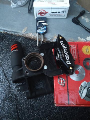

  9. Yeah has definitely saved me a lot of headaches. Put together the rear wheel bearings this afternoon. And should be able to bolt up rear brakes tomorrow. pretty excited. will get some pics up of the assembly.

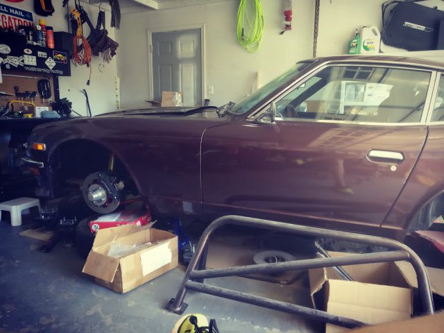

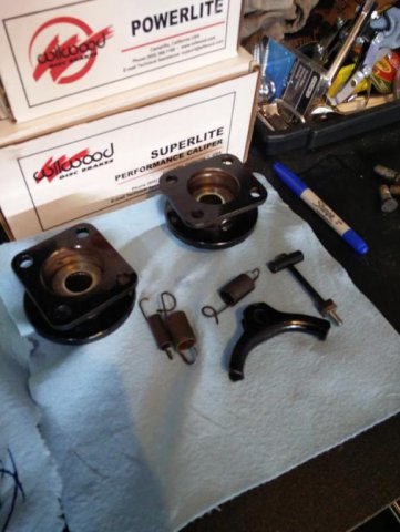

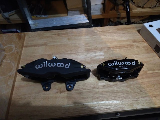

  11. So this is where I realize that I am not going to be ready for Z con in August in my back yard of Toronto Ontario..... but making progress non the less. Here are some shots of other items going in. Companion flanges and e brake hardware after a coat of paint. Rear carriers/hub after a coat of flat black. Along with outer stub axles. This is all ready to go back together. I have also ordered (almost a year ago) Front and rear disc brake set up from Gabe at T3. Awesome product. (we have decided that the caliper bracket needs to be flipped. As well got back the MSA SCCA roll bar from JP at Stripping Technologies, who has powdered coated it to match the paint! So from here on out I am going to try and keep up more detailed posts about each mini project. Would love any extra knowledge on this if you are following. Thanks all!

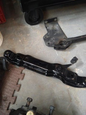

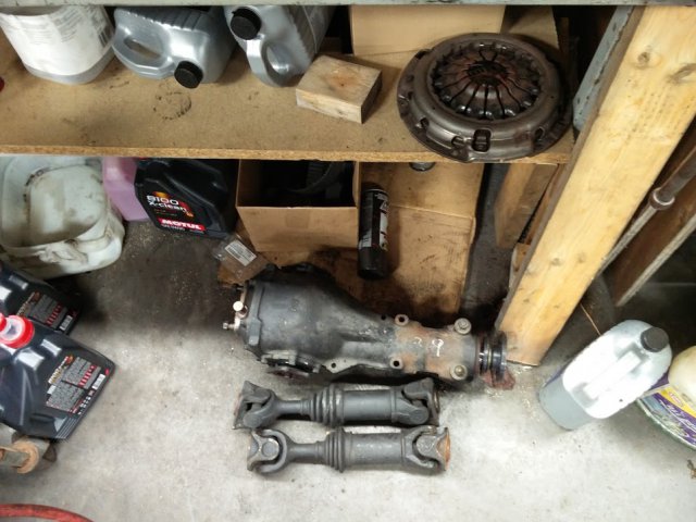

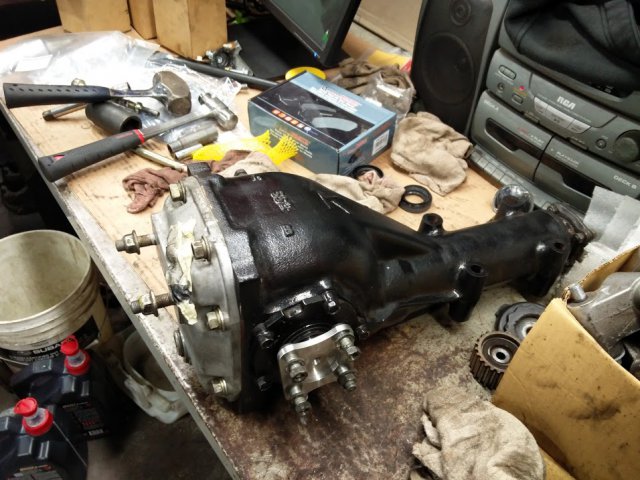

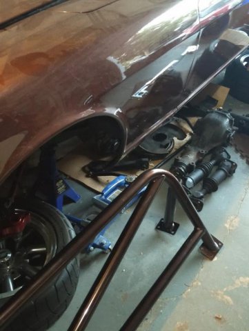

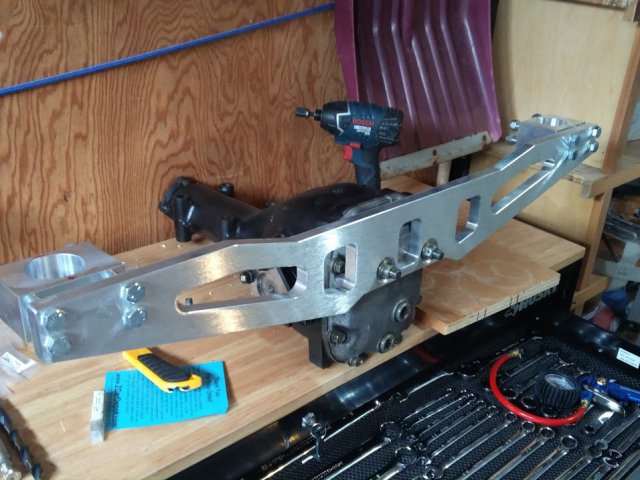

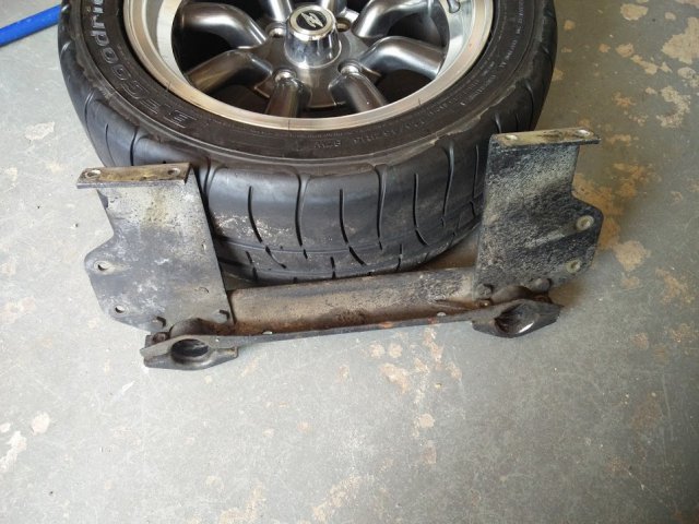

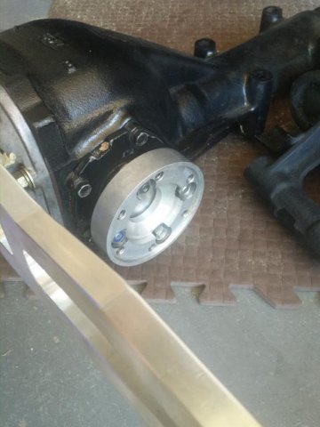

  12. So the open 3.90 diff was dropped out with the mini prop shafts. Picked up a Subaru r180 with a 3.90LSD from an importer in Montreal Quebec. Got a set of the Beta Motorsports stub axle/adapters. (which are just art.....god they are pretty.) and new studs. (I have new nuts from MSA just not in the picture) All mated to the T3 Moustache bar. Side note Gabriel at t3 is amazing. and the product craftsmanship is beautiful. Removed the drop mounts and dog bone.... and got some more t3 goodness. cleaned up and refinishing pretty much everything that comes out before it goes back in. This is the forward- inner LCA/dif mount

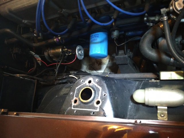

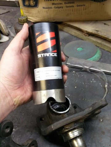

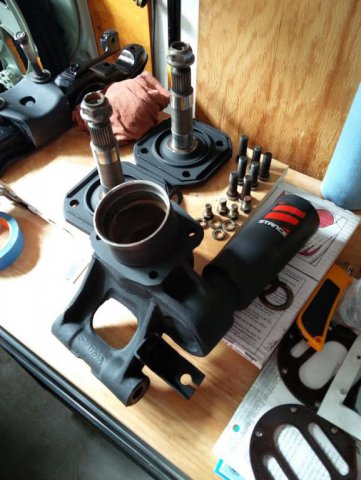

  13. More time passes and winter of 2015, a couple of buddies, (Rick and Robbie) come over and we pull out one seat, and the front suspension,,,,and half of the rear suspension. I had collected more parts in this time. Here is the T3 GTx2 front control arms, along with RCA. Started cutting the strut towers for the camber plates. where I don't have air in the shop, I used a dremmel with the new cut off wheels they are offering. Worked well, but expensive, as you tear through discs. I think I used 20 discs I ended up having the vanity plates powder coated to match the car by JP at Stripping Technologies in Cambridge ON. He has an amazing 510 with an engine from an AP1 s2k. JP has been a wealth of knowledge and an amazing beast of a human to have in your corner through a long build. Took front a rear components up to Works Garage and JP and Cambridge James helped to section the front strut tubes. After Cambridge James, (beauty 280z build) and JP and I got out one of the spindle pins, JP took the other half of the rear suspension to Hit Man Hot Rods, and they removed the other spindle pin (with great effort) , sectioned the strut tubes and welded the rear collars to the carriers. New hardware, wheel bearings all waiting to be installed.

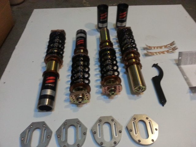

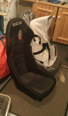

  14. So on the way home from C&C car starts making an awful grind scrape noise going over bumps. Get the car back to the shop.....Find that all the chasing my friends 88 911 through the country roads ( and maybe a few bumps) has resulted in a broken DS rear coil spring. I had been researching the shit out of the coil over options at the time ( on here and other sites- the thread is still open), and this was the excuse that allowed me to pull the trigger. I ended up ordering the set up from Sakura Garage. They make their own camber plate, and pair it with a set of Stance Coilovers. Awesome quality and first rate customer support from Sakura Garage. So this is when things slow down on progress, and I basically start part collecting. Wheels are ordered (amazing group buy that I couldn't pass up) And was able to get a set of Work Meister CR01's in grey face with polished bronze lip. Thanks again Peter at NEXTMOD in Markham ON. Found a set of Z force productions BAMFZG flares on DPAN on facebook. I have yet to install....Might still call jpngarage and get their set. They just look to be more finished? could be off here. Would love input. Started hunting seats as well. Got a deal on these Chronosport fixed back seats as they were in stock at a supplier, and from my understanding Sparco is not making this seat any more. Narrow enough to fit the car but wide enough for my ass.
