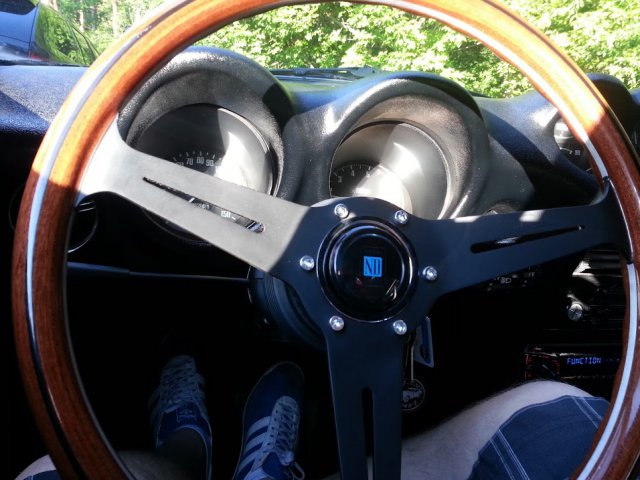

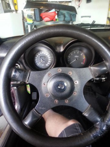

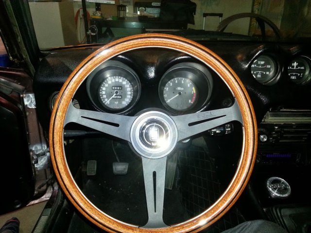

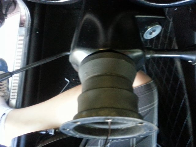

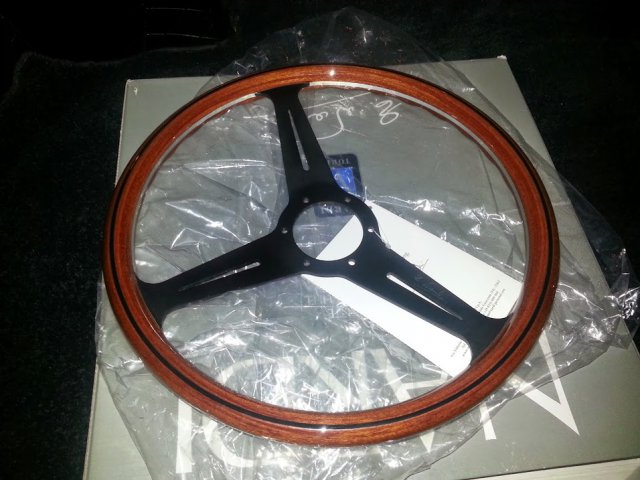

Hub was good. Installwas easy, fitment was good. I struggled a little with horn button but got it sorted. Whitehead Performance got me the hub. I didn't go with the deep corn. I am 6'4" and didn't want to have the steering wheel any closer.

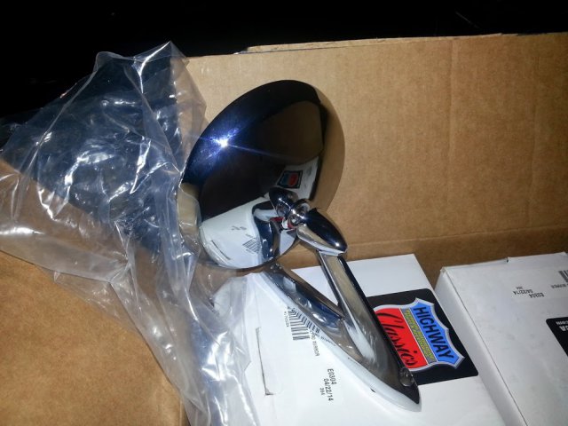

So as you can see, tires were 60 profile and the car looked vintage, but the age and the condition of the tires were questionable. As well the Mirrors were not the look I wanted. Long term goal was to get the car to have a similar look to Christine Sepika's 280z, but unique. Not looking to clone. Just absolutely fell in love with the wheels and the wide zg flares. I now had direction. ( And Christine was nice enough to share wheel specs so I could put my order in to Works. So second summer with the car it was time for tires. you could swing the ass out any time. They were dry. (but super fun) Set of BFG Rivals added the grip, and bumped up the speed you could confidently carry. Received a steering wheel from my wife for birthday gift. (best wife ever) and ordered up a boss hub from Whitehead Performance in Scarborough Ontario. These guys are awesome. Tons of help. Old Wheel Old Hub New Hub from White Head New Nardi Wheel Found the black center ring on the wheel would not stay on. So hunted down some nice SS allen headed hardware and decided to ditch the ring. Took off the inner door skins and removed those plastic accordion mirrors. Replaced with a set from MSA. The plan is to run these until body work money is saved then door mirrors shaved and fender mirrors will be added. So in the mad dash to have mirrors and wheel on for the July cars and coffee in Concord hosted by Engineered Automotive.....My starter shits the bed. Whitehead performance to the rescue with a gear reduction starter. Car ready. Off to first show with the car! There were many more cars there that day, this was at roll in at 7:30am. Think there might have been 25 cars there at this point.
