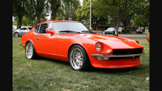

kevinz Posted January 26, 2016 Author Share Posted January 26, 2016 Something like this car Quote Link to comment Share on other sites More sharing options...
