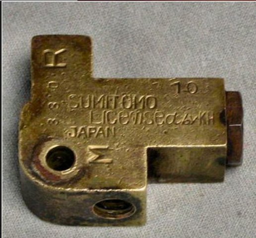

My brake pedal was also rock hard some times and it seemed like it was only the front wheels braking. The problem on my car was the rear brake proportioning valve that was more or less blocked. I removed the valve function so it is just a connection point now and installed a external proportioning valve. That solved my problem, but perhaps your problem are different.
