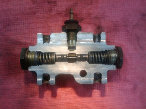

Right now I am running the original prop valve in the rear, as well as the original "differential valve" in the engine bay.
I am looking for more rear bias.
Shoudl I retain the original "differntial valve in the engine bay and install an inline wilwood prop for the rear?
Or should I remove the OEM rear prop valve as well as the differential valve and install a willwood 260-11179 in its place?
What is the purpose of the original differntial valve in the engine bay? Right now I am noticing my front left caliper is much stronger than my front right, no leaks or seized pistons.

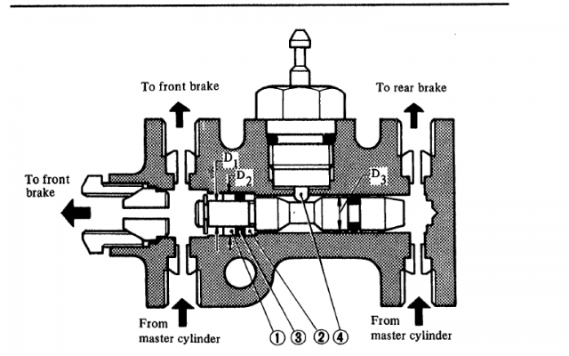

The differential pressure safety switch turns on a red light on the dash if there is a leak in the front or rear brake circuits. All that happens is the piston inside moves  to the low pressure side if there is a leak on that side and turns on the  red light. That is it. Removing the differential pressure safety switch does not improve anything. Leave it alone.

Appreciate your response. I am removing the rear pressure regulating valve (located in the rear of the car on early cars and in the engine bay on later). Are you saying that with this valve removed, and full flow going to the rears, my setup will be still front biased and the rears will not lock? Would be pretty crazy if that were true.
So since that brake switch just triggers a warning light, I will remove it and get the  260-11179 .

My Main question here was whether or not I can remove the stock brake switch/splitter. From the looks of it I can.

Yes, you can replace the brake pressure differential valve (aka brake switch) with a three-way connector as shown in the attached picture. Do not consider "gutting" the switch as you would be connecting the front and rear brake circuits together.
