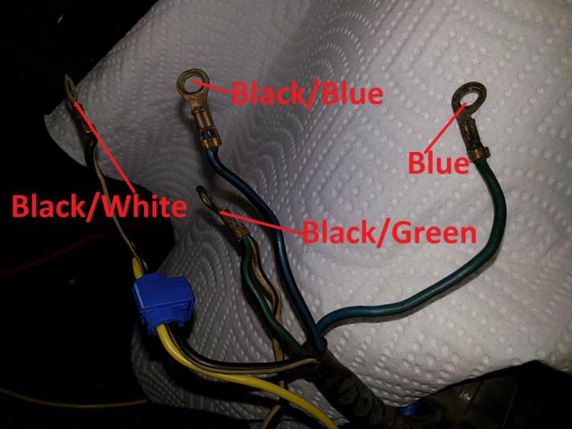

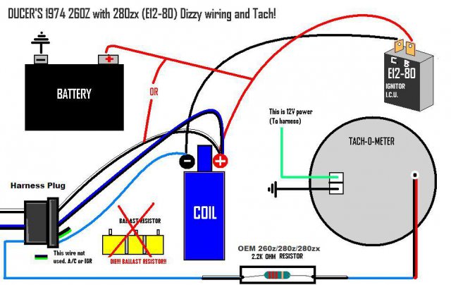

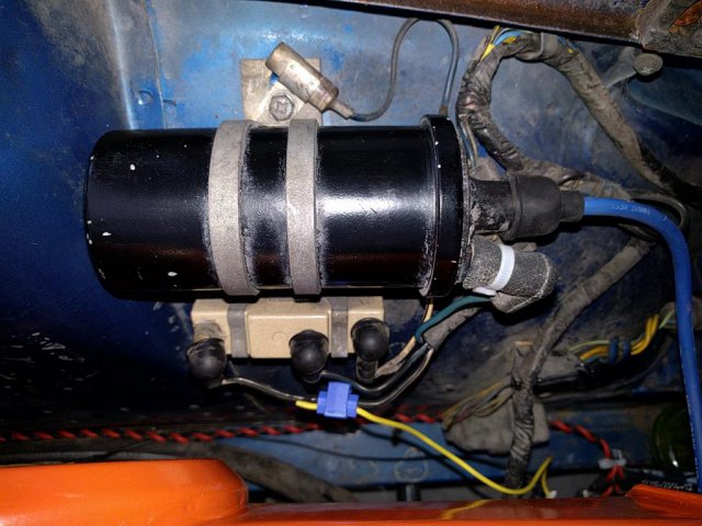

rustler753 Posted April 15, 2016 Share Posted April 15, 2016 (edited) So it has been discussed before, but in my searches I couldn't find a solution to my particular wiring problem. Here is what is going on. Busted out the multimeter and here are my observations. See attached for the wires I'm working and my wiring setup. Black/White: 12V ignition on, voltage drops during cranking. Black/Blue: No voltage ignition on, 12V during cranking. Black/Green: No voltage on, No voltage crank. Blue: No voltage on, No Voltage crank. My understanding is that 12V should be oscillating on the (+) and (-) on the coil, but as my wife cranked the car, I had the mutlimeter on the +/- and only saw 12V constant, I didn't see it drop out. I'm not sure what to test next, it seems pretty clear the coil isn't getting power but I wired it exactly like how the Atlanta Z car club wrote. Anyone have recommendations on how to wire this thing up? (I have removed the transistor module) This is how it used to be wired up with the old ballast resistor/dizzy (see 3rd attachment), my ballast resistor was a 3 pole unit: black/white on resistor +, black/blue on resistor center, and black/green on resistor -. The white/black paired with the black/green went to coil - and the capacitor as well. The tach was on coil (+). Edited April 15, 2016 by rustler753 Quote Link to comment Share on other sites More sharing options...
NewZed Posted April 15, 2016 Share Posted April 15, 2016 Black/White: 12V ignition on, Black/Blue: No voltage ignition on, 12V during cranking. . Blue: No voltage on, No Voltage crank. I'm not sure what to test next, it seems pretty clear the coil isn't getting power but I wired it exactly like how the Atlanta Z car club wrote. You're showing a blue wire in your drawing from the coil negative to the tach. Is that the Blue that gets no voltage above? If so, that would mean you have an open circuit in the coil. The coil is bad. With the key On and engine off, voltage should be the same on positive and negative sides of the coil. But you need to measure it with the wire attached to the coil negative, not disconnected. Power IS getting to the coil on the BL and BW wires. Otherwise, everything looks correct in your picture It should work like that, with a good coil. don't forget to make sure the distributor body is well-grounded also. That's where the current goes after it passes through the module. Quote Link to comment Share on other sites More sharing options...
rustler753 Posted April 15, 2016 Author Share Posted April 15, 2016 You're showing a blue wire in your drawing from the coil negative to the tach. Is that the Blue that gets no voltage above? If so, that would mean you have an open circuit in the coil. The coil is bad. With the key On and engine off, voltage should be the same on positive and negative sides of the coil. But you need to measure it with the wire attached to the coil negative, not disconnected. Power IS getting to the coil on the BL and BW wires. Otherwise, everything looks correct in your picture It should work like that, with a good coil. don't forget to make sure the distributor body is well-grounded also. That's where the current goes after it passes through the module. The blue wire is from the tach which has been in several examples as the trigger that lands on the (-) side of the coil for this conversion. I did these measurements with all the wires disconnected in the 2nd attachment and used the chassis for ground reference. Should the (-) and (+) on the coil both have 12V reference to ground when everything is attached when the key on and engine off? I also have a pertronix 1.5ohm flamethrower coil but I had the same results when I tried that coil... Quote Link to comment Share on other sites More sharing options...
NewZed Posted April 15, 2016 Share Posted April 15, 2016 Yes, with no current flowing the + and the - of the coil will read the same voltage, battery voltage, to ground, with the key On. Just measure at the terminals of the coil, with everything connected. Hook it up like your picture and it should be ready to start. Quote Link to comment Share on other sites More sharing options...

Kurbycar32 Posted April 15, 2016 Share Posted April 15, 2016 I just went though this on my early 260z and it turned out i had a bad coil that really confused things. The coil worked with the factory 260z distributor but pretty much failed to function with the 280zx dizzy. I used this document and its working. Be sure to unplug your ignition module from the passenger footwell, if you leave that in with the zx dizzy your car wont run or at least mine didnt. http://forums.hybridz.org/topic/104933-1974-260z-with-e12-80-280zx-distributor-swap-wiring-with-tach-hook-up/ Quote Link to comment Share on other sites More sharing options...

rustler753 Posted April 16, 2016 Author Share Posted April 16, 2016 I just went though this on my early 260z and it turned out i had a bad coil that really confused things. The coil worked with the factory 260z distributor but pretty much failed to function with the 280zx dizzy. I used this document and its working. Be sure to unplug your ignition module from the passenger footwell, if you leave that in with the zx dizzy your car wont run or at least mine didnt. http://forums.hybridz.org/topic/104933-1974-260z-with-e12-80-280zx-distributor-swap-wiring-with-tach-hook-up/ I have the pertronixs flamethrower too but both didnt work, I did pull out the transistor ignition module out. That post is also what I followed in detail, but I can't seem to get it to turn Quote Link to comment Share on other sites More sharing options...
Kurbycar32 Posted April 16, 2016 Share Posted April 16, 2016 Newzed touched on all the troubleshooting points but heres exactly what i would do: 1. disconnect the blue wire entirely and don't worry about the tach until the car runs. 2. run through the coil test procedure in your book. I beleive my coil is close to 1.5 ohm. I couldn't get the new dizzy to work at all with a higher resistance coil, specifically a 3.5 ohm bosch blue. in this case a stock coil works perfectly 3. working with a known good coil with the tach and ignition module disconnected if it still doesnt work look at the ignition module on the zx dizzy. I was unable to find a test procedure for these but do a resistance test on it. If the circuit is wide open is definitely bad but we cant prove its good with a resistance test (that i know of). Quote Link to comment Share on other sites More sharing options...
