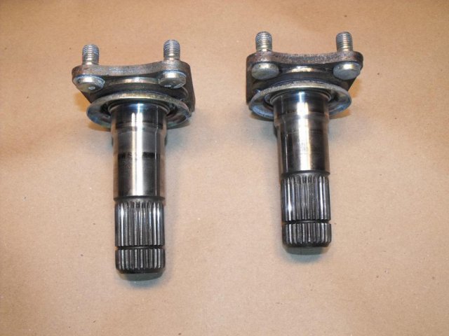

~KnuckleDuster~ Posted June 18, 2016 Share Posted June 18, 2016 Ok I'm about to put the new R200 in but noticed the passenger side stub axle sticks out more than the driver side. They poped firmly into the c clips but I can't recall if this was the way it was before. Need some piece of mind before I put everything back. Passenger Driver Side Quote Link to comment Share on other sites More sharing options...
Miles Posted June 18, 2016 Share Posted June 18, 2016 (edited) Did you install new seals? Do your side shafts look like the attached picture? Edited June 18, 2016 by Miles Quote Link to comment Share on other sites More sharing options...
~KnuckleDuster~ Posted June 18, 2016 Author Share Posted June 18, 2016 I personally didn't but they look like they could be new. Yeah they look just like the pic. They are installed as they should with the shorter one on the driver side. The only thing that's different now is this is a clsd diff and the previous was open. Quote Link to comment Share on other sites More sharing options...
~KnuckleDuster~ Posted June 18, 2016 Author Share Posted June 18, 2016 (edited) Ok so by switching them around, long end on driver side and short on passenger side they pop in place perfectly. I've searched around and never came across anyone saying the stub's had to be flip flopped when changing to a clsd unit, or am I the first person to go from a 280zx R200 with 280z stub axles to a R31 skyline clsd R200 with 280z stub axles.. Look new to me Old diff..definitely used Edited June 18, 2016 by ~KnuckleDuster~ Quote Link to comment Share on other sites More sharing options...
