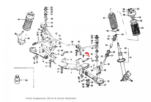

NewZed Posted June 22, 2016 Share Posted June 22, 2016 5? Quote Link to comment Share on other sites More sharing options...
Ctweber01 Posted June 22, 2016 Author Share Posted June 22, 2016 Thanks but it seems you identified a bolt on front suspension. I need bolt that attached transmission cross member to frame. Quote Link to comment Share on other sites More sharing options...

NewZed Posted June 22, 2016 Share Posted June 22, 2016 Clarity can be tough. Nissan calls the transmission mount the rear engine mount. Hard to tell which mount you're talking about. Regardless, every item except the long bolt for the rear mount attachment to the body is in that link, with part number. It shows the bolt but doesn't ID it. Your Nissan dealer will have the number. Good luck. Can't find bag of bolts to mount motor and transmission cross member. I need cross member bolts/nuts, nut to attach transmission to crossmember, and bolts to attach engine to engine mounts (isolator). Quote Link to comment Share on other sites More sharing options...
