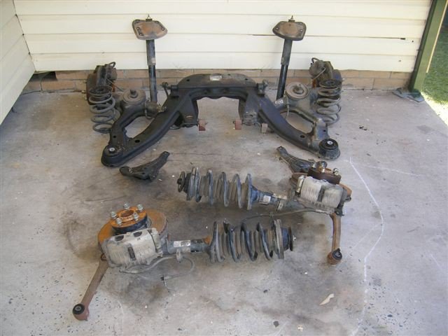

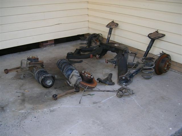

Boy from Oz Posted June 29, 2016 Share Posted June 29, 2016 (edited) I believe the rear suspension sits in a cradle. Do you mean the whole suspension or just the diff? The 2004 GTO diff I used preceded the all alloy G8 diff but offered a choice of 5 or 6 ratios from 2.89 to 4.11. Off the top of my head I think they are 2.89, 3.08. 3.46. 3.8x? and 4.11 http://forums.hybridz.org/topic/69682-gm-lsd-irs-diff-in-s30-fits-like-a-glove/ http://www.viczcar.com/forum/topic/12048-tutorial-holden-diff-fitted-to-a-240z/ Here is a photo of the cradle from my donor car. Edited June 29, 2016 by Boy from Oz Quote Link to comment Share on other sites More sharing options...
