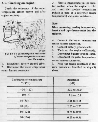

NewZed Posted July 20, 2016 Share Posted July 20, 2016 The obvious one is the coolant temperature sensor. Are you really in Poland, or just goofing? http://www.nicoclub.com/FSM/280z/ Engine Fuel, read the chapter. Also, you'll get better ideas if you are more descriptive than "playing". To some people that means hitting with a hammer,to others it's going through a complete calibration process. Quote Link to comment Share on other sites More sharing options...
Leon Posted July 21, 2016 Share Posted July 21, 2016 Check to make sure you haven't accidentally swapped the thermotime and coolant temp switch connectors. That will cause a rich condition. Quote Link to comment Share on other sites More sharing options...
BlueZed Posted July 21, 2016 Author Share Posted July 21, 2016 No goofing. Why are you asking? Good point- by 'playing' I meant unscrewing idle switch and rotating it. I've taken all of EFI wiring back on intake manifold (I've tucked it a bit during assembly). Dunno if this is original thing but coolant temperature sensor wire has bannana plugs half way through. They were disconnected. Reconnected everything, idles quite high, but no more black smoke. Seems like you guys have found a reason We will see after adjusting the rest once again, I'll let you know Quote Link to comment Share on other sites More sharing options...
